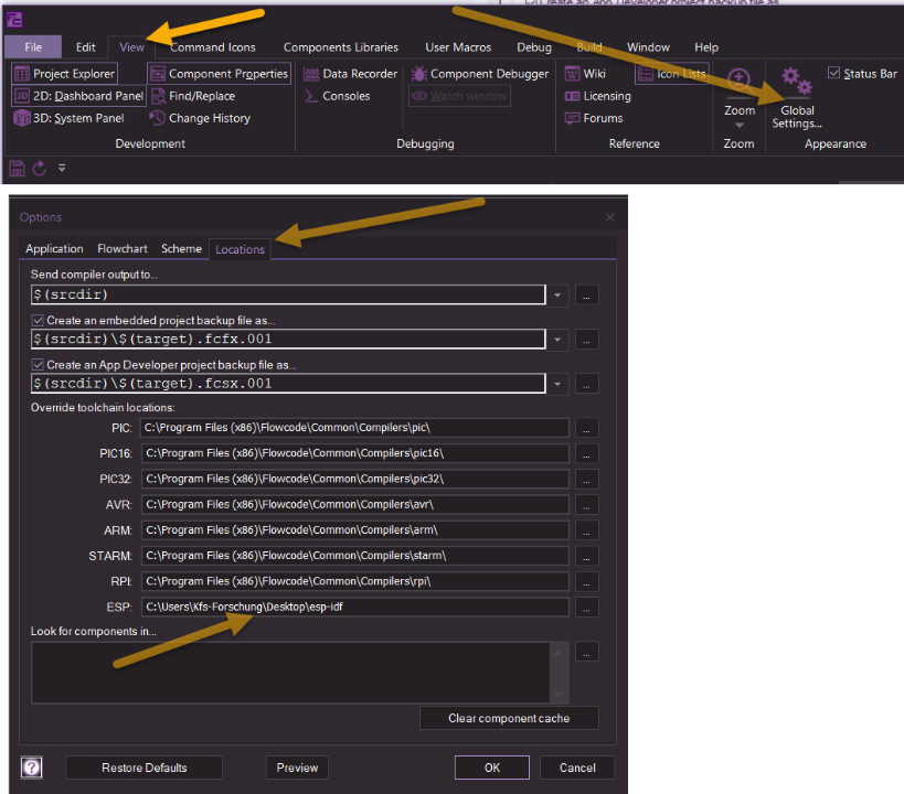

You need to 'point' Flowcode at the ESP toolchain location. Open Flowcode and set it in the "Locations" tab of "Global Properties".
Re: ESP 32 Toolchain problem
Posted: Thu Mar 11, 2021 5:43 pm
by stefan.erni
Hi Felix Hi Steven
like this

Thank you Stefan
Now I'm one step further. The Toolchain was installed now.
