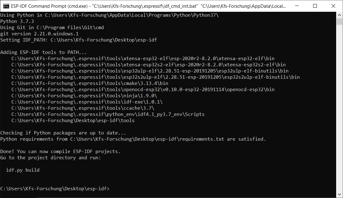

Re: ESP 32 Toolchain problem
Hi Felix
It's look like this:
felixegger
Posts: 48
Joined: Wed Feb 24, 2021 1:20 pm
Been thanked: 2 times
Post by felixegger »
Yes, I found it, but did not manage to run anything.
Please help again, Thanks
