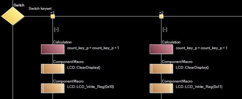

Hi Stefan,
Great thanks for letting us know. I've now exposed the macros for you and commands are done like this. The write reg sends the command code and the write data sends the data byte(s) if required.
For example
The display off and enter sleep mode commands should put the device into low power mode. Then wake up again with a call to the initialise macro.

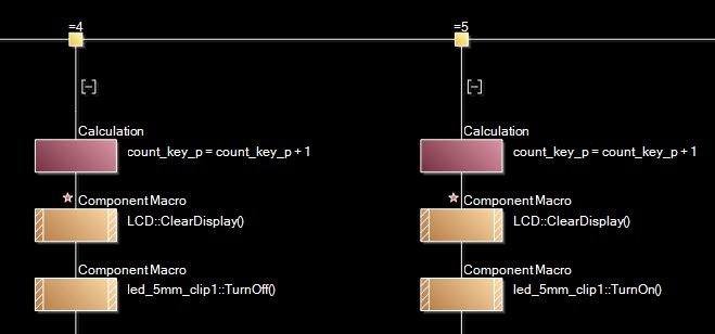

Hi Ben, Hi Jorgen
The commands are working fine and the display goes to sleep and wakeup if I press a key.
The power goes from 140mA to 138mA (the complet board)
But if I use the LED Pin to turn on/off the pin B0
The power goes from 140mA to 70mA ! (the complet board)
I'll take a closer look next week.
@Jorgen Thank you, Ben has already solved everything.
Commands:
