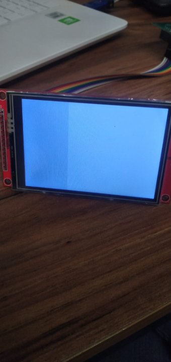

Re: STM32-SPI-ILI9488
It looks like something is happening. What if you try altering the display component properties and swapping the width and height values.

Hi, I did this yesterday, but still nothing has changed. In fact, it seems that tft does not accept the data of the SPI and does not show any reaction ... :?

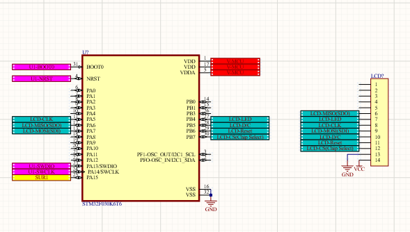

Hi, I've added all the files related to the project If you see an error, please let me tell you happy ...
Test.fcfx
(12.57 KiB) Downloaded 789 times

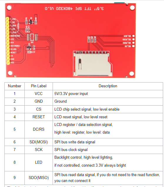

TEST ILI9488.png (57.69 KiB) Viewed 12698 times
ILI9488 PIN.png (210.79 KiB) Viewed 12698 times
