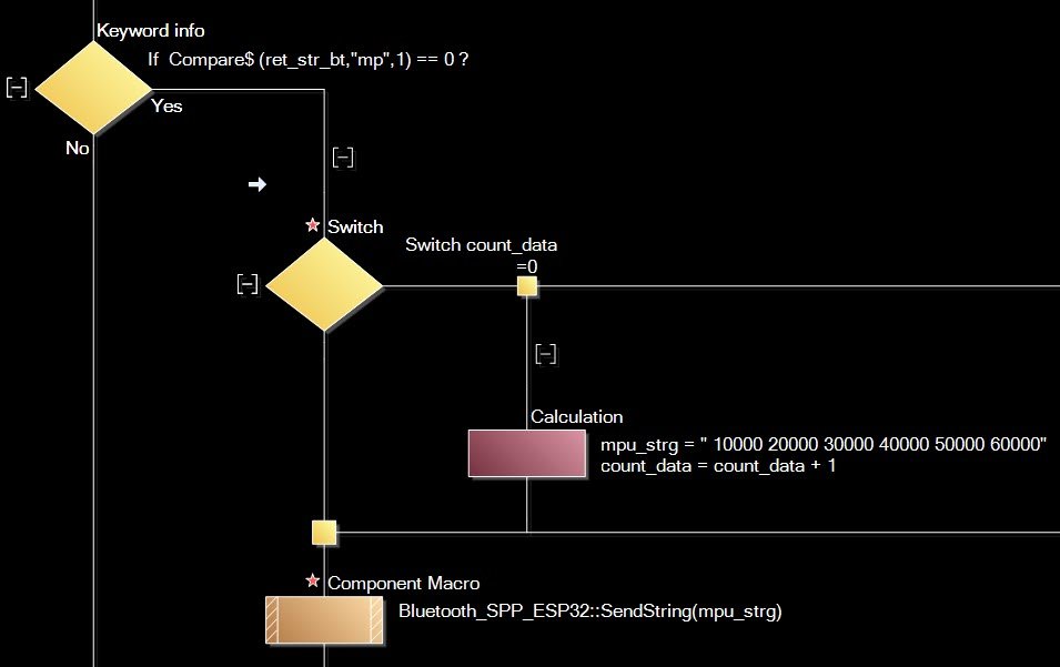

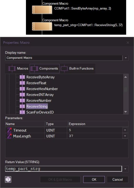

No interrupt on the App Developer. OK.
So I made a pooling from the App Developer to the ESP32 by Bluetooth. I send 2 char "mp" from the App Developer.
Then the ESP32 is sending immediately from the Bluetooth interrupt a string with 36 char back.
It's working fast.( I set the baudrate from the comport to 2'000'000)
Later I try to do the same way a pooling with a SendINTArray from the ESP and ReceiveINTArray in the App Developer instead of an string
I hope it will work also that fast. For this array I already asked Ben.
https://flowcode.co.uk/forums/viewtopic ... 6227#p6227
I will post the result here
App Developer;
ESP32:
