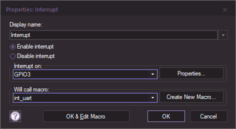

Hi Dvcam99
Interrupt is working on my esp32. I used A3 for rx pin
and
GPIO3 for the Interrupt
Re: ESP32 UART RXINT interrupt is missing
Posted: Fri Jan 08, 2021 10:52 pm
by dvcam99
Hi Stefan,
many thanks for the feedback.
Yes I saw this possibility too but you can trigger only at the rising or falling edge of the input.
I`m looking for example for incoming received byte trigger. Same like we have in the PIC8 section.
BR
Dirk
