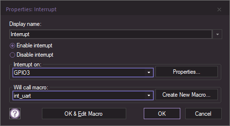

Hi Dvcam99
Interrupt is working on my esp32. I used A3 for rx pin
and
GPIO3 for the Interrupt

Hi Stefan,
many thanks for the feedback.
Yes I saw this possibility too but you can trigger only at the rising or falling edge of the input.
I`m looking for example for incoming received byte trigger. Same like we have in the PIC8 section.
