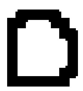

Is there a way to draw a triangle like an up down arrow or a button with rounded corners? I have tried the ellipse but dose not give me the results I'm looking for.
Re: ili9341 various macros
Posted: Wed Jun 15, 2022 10:10 am
by BenR
An arrow could be done using lines or plot points.
A rounded box could be done by adding black lines to the outside of a rectangle and white to the inside as shown here. This is a bad example hand drawn by me but shows you what kind of things you can do.
Rounded Box.jpg (5.4 KiB) Viewed 6545 times
Here's a much better example from the web.
Ideally you use COS and SIN to do the X,Y dims for you.
If you think these are something that should be standard on all GLCDs then let us know and we can maybe investigate.
