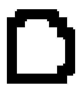

Is there a way to draw a triangle like an up down arrow or a button with rounded corners? I have tried the ellipse but dose not give me the results I'm looking for.
- Posts: 2239
- Has thanked: 615 times
- Been thanked: 814 times
Re: ili9341 various macros
An arrow could be done using lines or plot points.
A rounded box could be done by adding black lines to the outside of a rectangle and white to the inside as shown here. This is a bad example hand drawn by me but shows you what kind of things you can do.
Here's a much better example from the web.
Ideally you use COS and SIN to do the X,Y dims for you.
