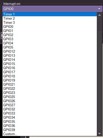

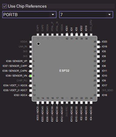

The ESP32 has about 39 IO Pin but I can not set the interrupt to the Pin IO36-IO39
Interrupt set and Port select:

Thanks for letting us know, should be sorted for you now via the library updates.

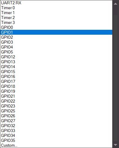

Thanks a lot. The IO39 works fine but IO37 and IO38 not yet
Not on display IO37 and IO38

Hmm looks like the ESP32 and ESP32s targets slipped through my net, 36-39 should be there on all targets now.

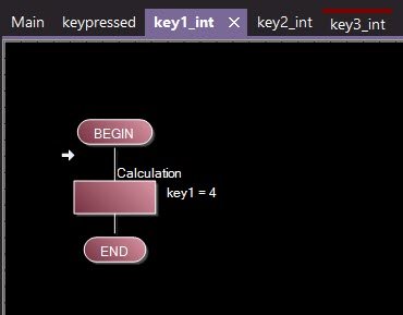

I tested in a hardware 3 Interrupt with 3 key.
If I put just a Calculation in each interrupt then its working fin.
For key1 add 4
For key2 add 2
For key3 add 1
I have to call every 100ms a macro "keypressed" an check if a key is pressed and select in a case which one.

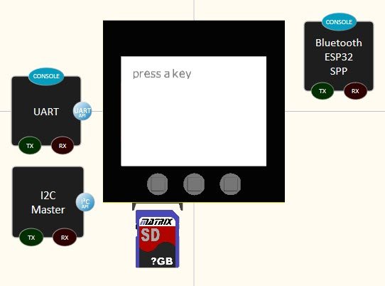

In the Program I let a dot move over the screen to test if there is a break while pressing long . But it's ok. No break
and I count how many times I pressed a key and all is ok.
All looks as its working nice,
with the restriction I have to call about every 100 msec the macro. If I call to fast I can not detect more than one key
If I call much to slow it's not comfortable to use
