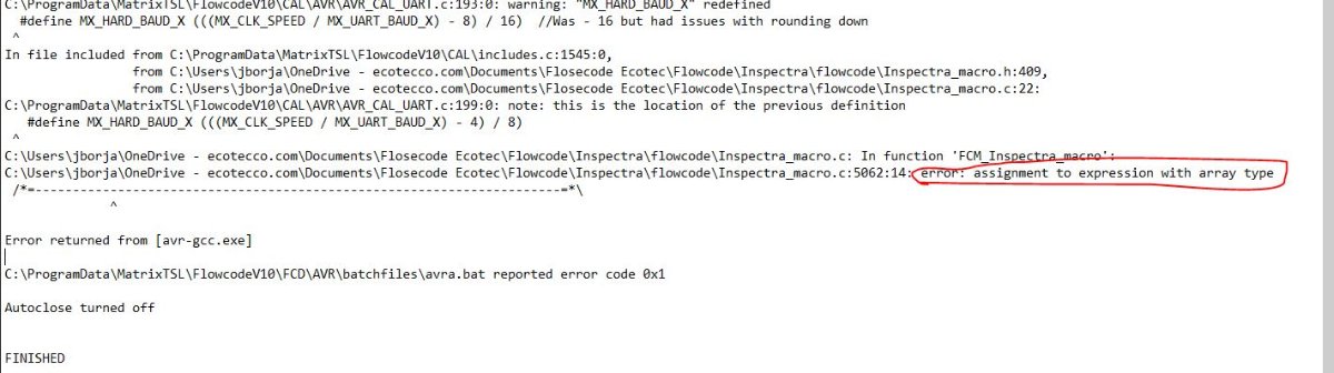

I am using UART to get a string from a device. I then went to parse/trim that sting before I sent it to the PC. When I "compile to HEX" only the .h and .c files get generated. I think the problem is the C Code icon I am using. When I toggle it off the .hex gets generated. I have attached my code and the error message when the c code not toggled off.

What you see is normal FC/Compiler will not generate a hex file if there is an error in the code,
You have an error in the way you are parsing the strings (I would think you should use a loop do that)
anycase the problem is that your C code generates an error and therefore the hex file is not generated

Your C code is illegal C. Specifically this line:
// Remove the first 3 characters from the string
FCL_BUFFER = FCL_BUFFER + 3;
FCL_BUFFER is declared as an array in Flowcode (local string "buffer[20]").
You are probably best off avoiding C code and using a calculation similar to following:
.buffer = Mid$(.buffer, 3, Length$(.buffer)-3)
