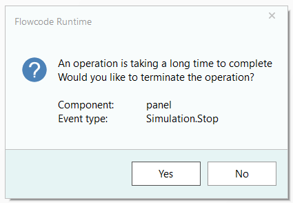

There is a Simulation Stop event that you could use to catch users clicking the stop button, In the event macro you could either restart the sim or close the app.

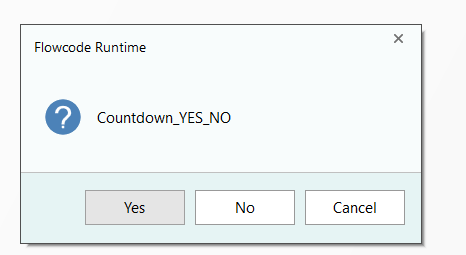

Yes, I understood a little but not completely.
The input Message window opens but the program is already closed.
Does that have something to do with the error message? I choose yes then the input Message windows open
But there is no count/down or count/up

You can't really have blocking code inside the event macro but I have edited the stop macro so that now it just starts the sim running again. Hopefully helps to avoid the user clicking that pesky stop button.
FC10_post_stop1.fcsx
(11.22 KiB) Downloaded 472 times
You might need to check that variable values aren't reset and if they are then you might need to store them in the stop event and restore them after.
