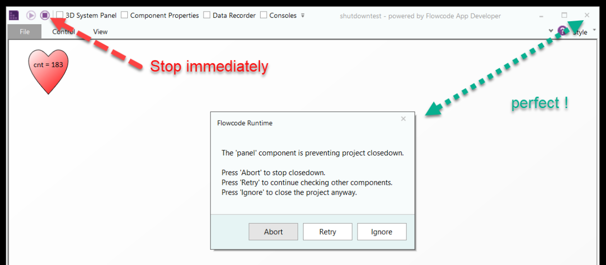

Just a little remark
Unfortunately, this small square stops immediately but the user should not use this.

Hi Stefan,
There is a Simulation Stop event that you could use to catch users clicking the stop button, In the event macro you could either restart the sim or close the app.

Re: App Developer Runtime close with a command
You can't really have blocking code inside the event macro but I have edited the stop macro so that now it just starts the sim running again. Hopefully helps to avoid the user clicking that pesky stop button.
You might need to check that variable values aren't reset and if they are then you might need to store them in the stop event and restore them after.

If you don't want the "stop" button in a deployed app, select ""no controls" or "start/pause" under "execution controls" when deploying it.
