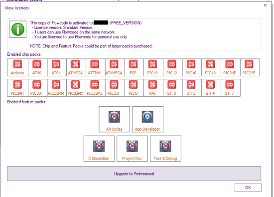

As all the components for FC10 are free, you should not be seeing that popup.
As a sanity check I have just used a free version of Flowocde v10:
FC10 Free version.png (86.4 KiB) Viewed 10522 times
The modified component allows to be added OK and is compiling for me.
The only reason for seeing the pop up is when you try and add a component that was created for FC9 or below in to
%ProgramData%\MatrixTSL\FlowcodeV10\Components

Re: HC-SR04 not working with ""Pic"" Anymore
Posted: Thu Aug 22, 2024 4:26 pm
by jgu1
Well ok Martin. Normal I have no problem with opening a FC9 project in FC10. Something newer? ;)
Still no luck with the new component. Now I get a new error.
Br Jorgen
Posted: Thu Aug 22, 2024 4:33 pm
by medelec35
The error is cause by the HC-SR04 pins being set to pins that don't exist
You need to change the pins from port A (as that does not exist within Arduino Uno) and select pins within port B, C or D
