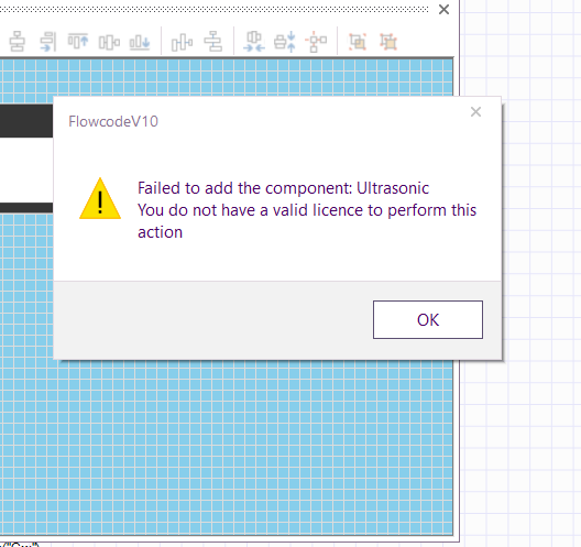

Hi Martin!
Sorry not working. If I try to open one of my previus project with the UL sensor, it missing on the 2D board and the componentmacro is strange.
If I then add a new macro I get the screen as you see on the picure.
By the way Martin, your earlyer UL component has working perfectly, why does it suddently not working??
I have the proffesional licence?
Br jorgen
Br jorgen

Re: HC-SR04 not working with ""Pic"" Anymore
Hi Jorgen.
As all the components for FC10 are free, you should not be seeing that popup.
As a sanity check I have just used a free version of Flowocde v10: The modified component allows to be added OK and is compiling for me.
The only reason for seeing the pop up is when you try and add a component that was created for FC9 or below in to
Can you try readded the attached component to then reload, or close FC10 then reopen
Does anyone else also have the same issue?
%ProgramData%\MatrixTSL\FlowcodeV10\ComponentsThe main reason could be a child of the component has changed, casing a knock-on effect.
%ProgramData%\MatrixTSL\FlowcodeV10\ComponentsDoes anyone else also have the same issue?

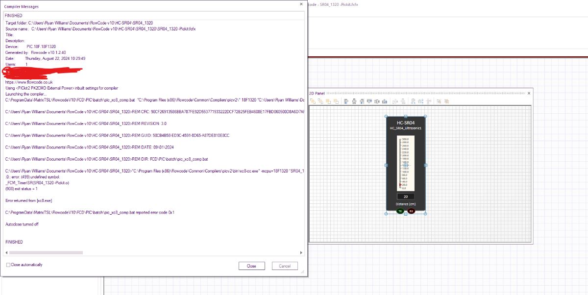

daddytims_tims
- Posts: 74
- Joined: Thu Jun 16, 2022 6:16 pm
- Has thanked: 125 times
- Been thanked: 13 times
Hi Martin
I just tried. It still doesn't work. I copy the file to the folder updated it, try compiled but fail.
I restarted the win 11/ project It still fails.
I am using v10
I am using v10
- Screenshot 2024-08-22 103027.png (201.72 KiB) Viewed 10498 times
