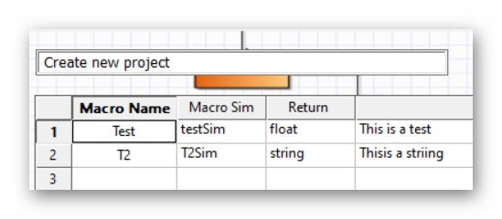

Fire up the program and type in Macro names and their Simulation macro equivalents by clicking on the grid (for example Test and TestSim you can use mouse or arrow keys to navigate)
Then click 'Source' and 'Save As' for experimentation I recommend using a empty program as the source (and always save as a new file!)
The program then saves the file with the new macros and their simulation macros created (also exported as downloadable macros & linked in the component configuration)
Note that if no sim macro is specified then just the macro is created (with no sim link/component export) (& vice versa)

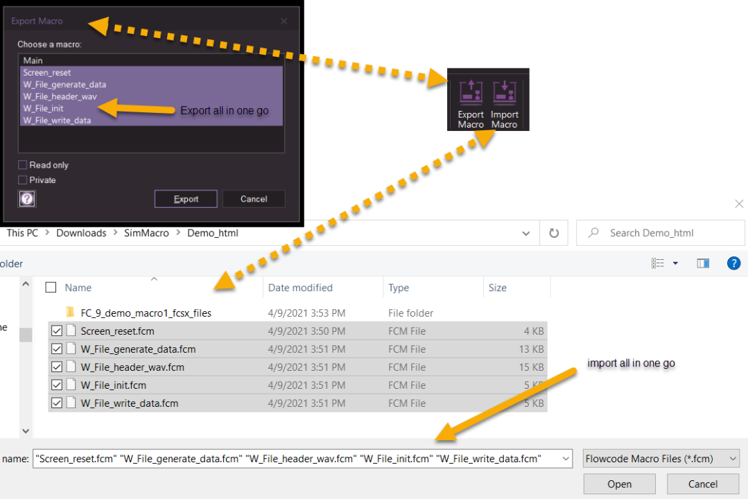

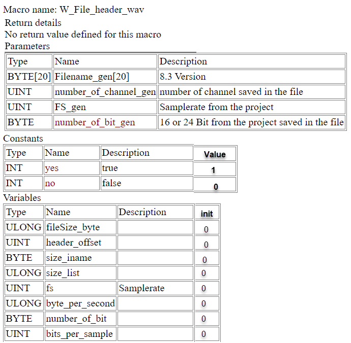

If i write a lot of macros i lose the overview.
But when I export the macros (all at once) and then import (all at once) into a new, empty project
and starting the automatic documentation I already have an HTML file, for example as a catalog of all of my macros.
If your magic macro tool is based on this format i think i could plan my macros better right from the start
here a html docoment from the automatic documentatio as a sample
Re: Macro Creator (feedback wanted)
Posted: Fri Apr 09, 2021 3:42 pm
by stefan.erni
with picture....
FC_9_demo_macroHTML_and_jpg.zip
(379.64 KiB) Downloaded 737 times

Now has a return type for macros (these are as per flowcode - leave blank for none (or indeed anything that doesn't match one of the other types - so null would be fine)
Types are none, bool or boolean, byte, int, uint, long, ulong, float, string and handle.
These are all handled correctly (string is a little more involved than the others)
Description - added to macro definition. If the macro is a simulation macro then '(sim)' is appended to the description.
One oddity - it only seems to work 'once' without a restart or file -> new ?

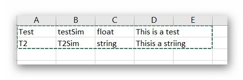

So I added cut and paste...
If you have some macro details in Excel - you can select copy and paste....
Select a cell (note don't be 'editing' the cell) and ctrl->v
Then source and Save As - as before...
mm cut and paste.zip
(2.88 MiB) Downloaded 821 times
