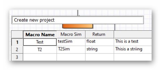

Fire up the program and type in Macro names and their Simulation macro equivalents by clicking on the grid (for example Test and TestSim you can use mouse or arrow keys to navigate)
Then click 'Source' and 'Save As' for experimentation I recommend using a empty program as the source (and always save as a new file!)
The program then saves the file with the new macros and their simulation macros created (also exported as downloadable macros & linked in the component configuration)
Note that if no sim macro is specified then just the macro is created (with no sim link/component export) (& vice versa)

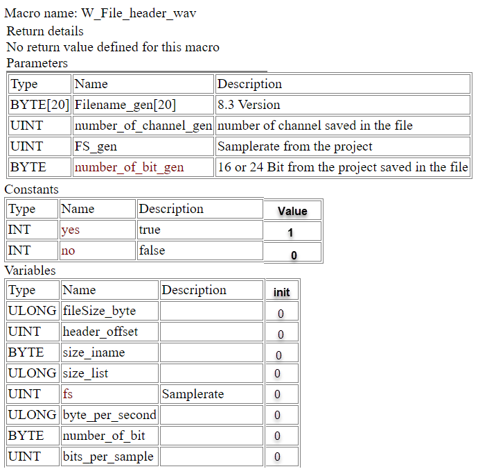

What about you add a source.fcsx and source.fcfx in your programfolder write protected
and save it as a new renamed fcsx or fcfx with the includet macro?
There is a Auto Documentation included in Flowcode under File/export
You can use this format just add Value and init value (maybe this can also be changed in the Auto Documentation)

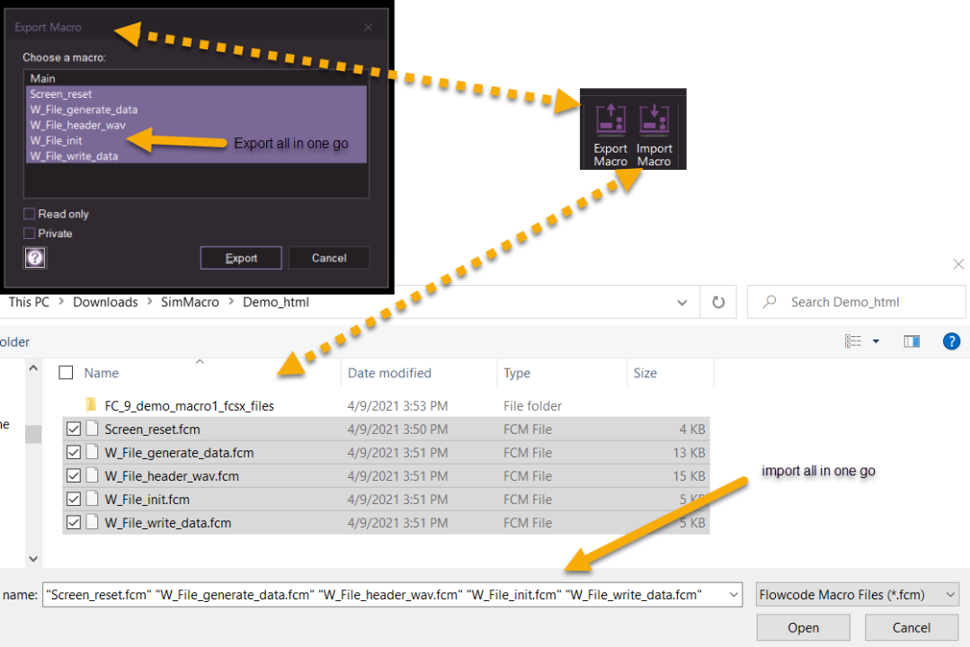

If i write a lot of macros i lose the overview.
But when I export the macros (all at once) and then import (all at once) into a new, empty project
and starting the automatic documentation I already have an HTML file, for example as a catalog of all of my macros.
If your magic macro tool is based on this format i think i could plan my macros better right from the start
here a html docoment from the automatic documentatio as a sample

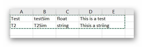

Loading Excel files is probably beyond the scope of this project..
CSV files would certainly be possible - and just had a play and can get 'cut & paste' working okay too (pasting from an Excel sheet with the 'expected' layout...)

So I added cut and paste...
If you have some macro details in Excel - you can select copy and paste....
Select a cell (note don't be 'editing' the cell) and ctrl->v
Then source and Save As - as before...
Allowing this actually reduced the program size by about 15% - it's now only 40 events!
