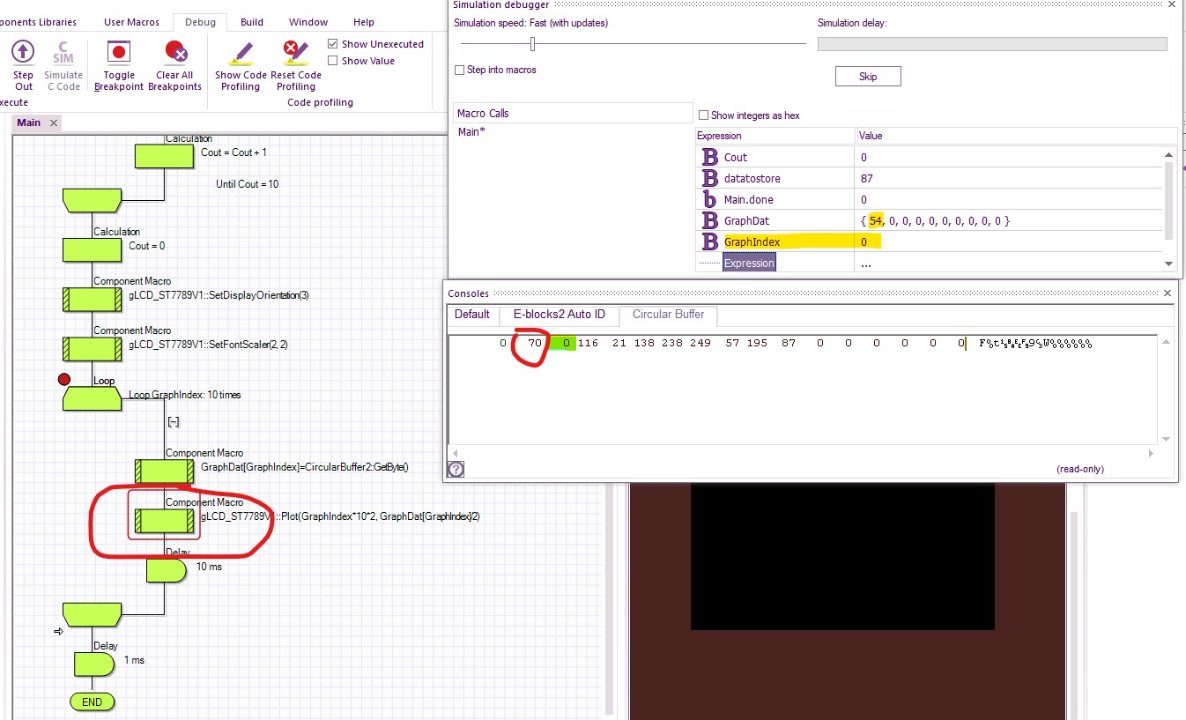

In my current program I already noticed a problem but I thought it was bad programming on my side, so I bypassed the problem.
I was making a small new program to test it before to include it my curent prog.
I saw that there is a problem with Circularbuffer GetByte()

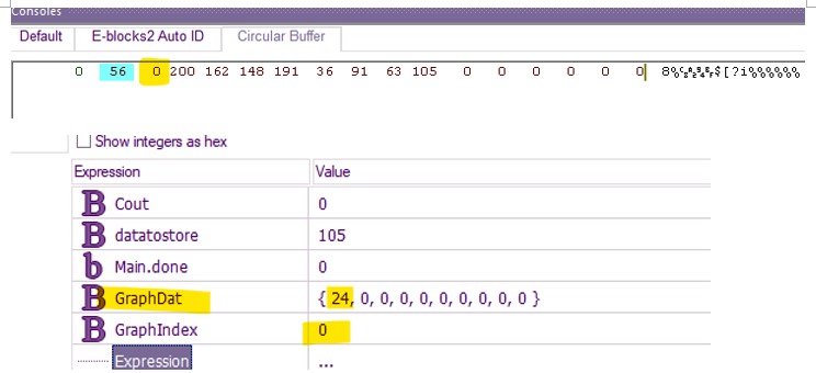

As you can see, there is 10 data in the buffer and the first on is 56
data in buffer.jpg (13.22 KiB) Viewed 9549 times
The problem is when call Getbyte() the first data to get is always the second one (in this case it will be 24) instead of the 1st one who is 56
data in buffer 1.jpg (35.05 KiB) Viewed 9549 times
It seems that getbyte start always with the second byte in the buffer , it mean with buffer position 1 instead of 0

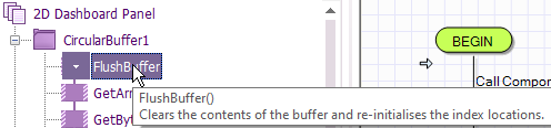

I don't believe the circular buffer simulation starts at 0 address when first run unless you start with FlushBuffer macro first.
The tool tips for FlushBuffer is:
Try that at the start and then see if it does as expected?
It could be the case of a bug and the index is not initialised as 0?
This can be looked into in the new year when we are back at work.
So long as the buffer returns the correct values since indexing is automatic.

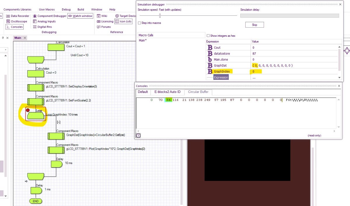

Before to getbyte 1st time.jpg (120.31 KiB) Viewed 9537 times
After getbyte 1st time.jpg (116.89 KiB) Viewed 9537 times
as you can see the first data was 54 instead of 70
thx

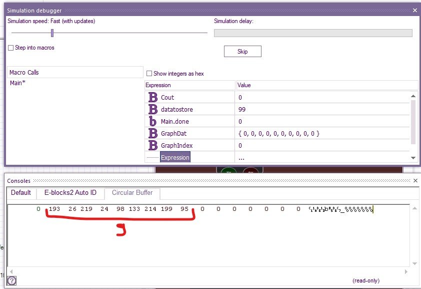

I made another test with size 10 for 10 data to store. (store first X value)
9 data was stored and 1 lost
9 stored.jpg (61.43 KiB) Viewed 9529 times

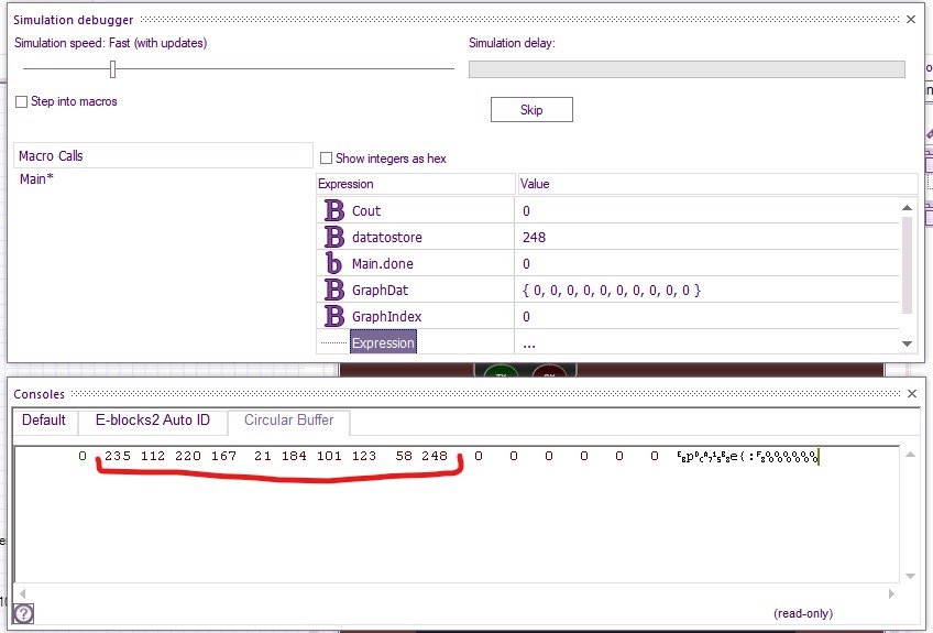

The second point is that the Circular buffer on the Console do not reflect the buffer.
10 data sent, only 9 in buffer but 10 in console. This is unsettling to be oblige to use buffer and simulation like this.
10 console.jpg (63.04 KiB) Viewed 9529 times

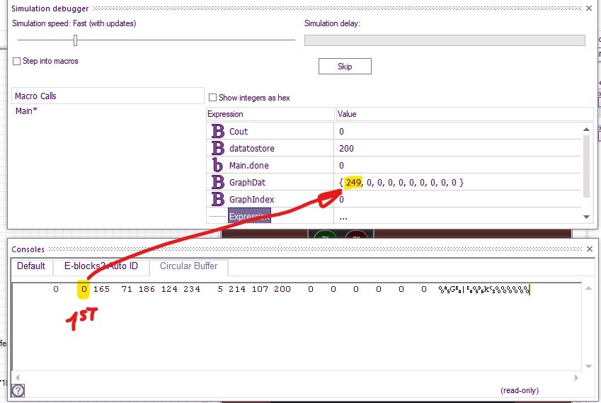

This causes another issue :
When discard buffer with get array, oldest entered value is never discarded !
1st test
- Buffer size5, 8 bytes to enter in buffer, 4 Bytes to discard with GetArray --> the oldest byte value who is 4 in the simulation stay in the buffer
2nd test
- Buffer size5, 8 bytes to enter in buffer, 3 Bytes to discard with GetArray --> the oldest byte value who is 4 in the simulation stay in the buffer
then at the next first Buffer PutByte, the oldest byte is overwrite !!!
Please check ASAP, it's already difficult to work with data so if in addition, the buffer doesn't work, it's a nightmare!!!
