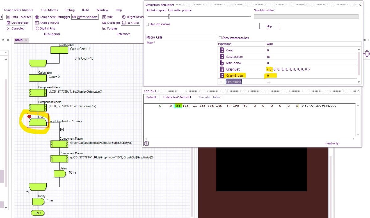

In my current program I already noticed a problem but I thought it was bad programming on my side, so I bypassed the problem.
I was making a small new program to test it before to include it my curent prog.

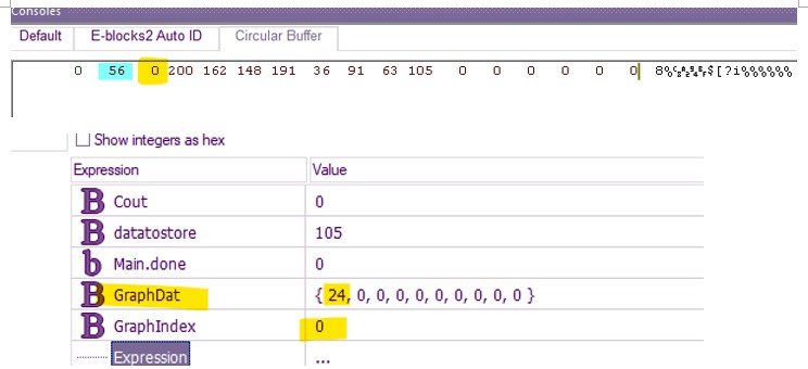

I saw that there is a problem with Circularbuffer GetByte()
As you can see, there is 10 data in the buffer and the first on is 56
The problem is when call Getbyte() the first data to get is always the second one (in this case it will be 24) instead of the 1st one who is 56
It seems that getbyte start always with the second byte in the buffer , it mean with buffer position 1 instead of 0
thx

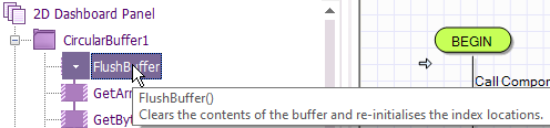

I don't believe the circular buffer simulation starts at 0 address when first run unless you start with FlushBuffer macro first.
The tool tips for FlushBuffer is: Try that at the start and then see if it does as expected?
It could be the case of a bug and the index is not initialised as 0?

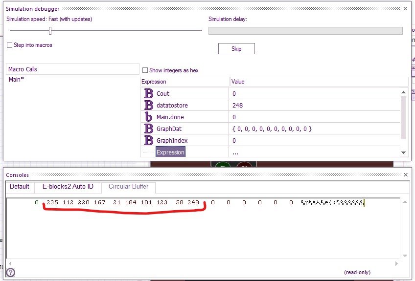

hi,
Of course there is a Circular buffer BUT , I used only the debug mode and simulation so the prog sent to you was not current prog saved but only the base! Sorry
please find below after been saved ! Flushbuffer was already used.
thx
No as you can see the first data was 54 instead of 70It could be the case of a bug and the index is not initialised as 0?
thx

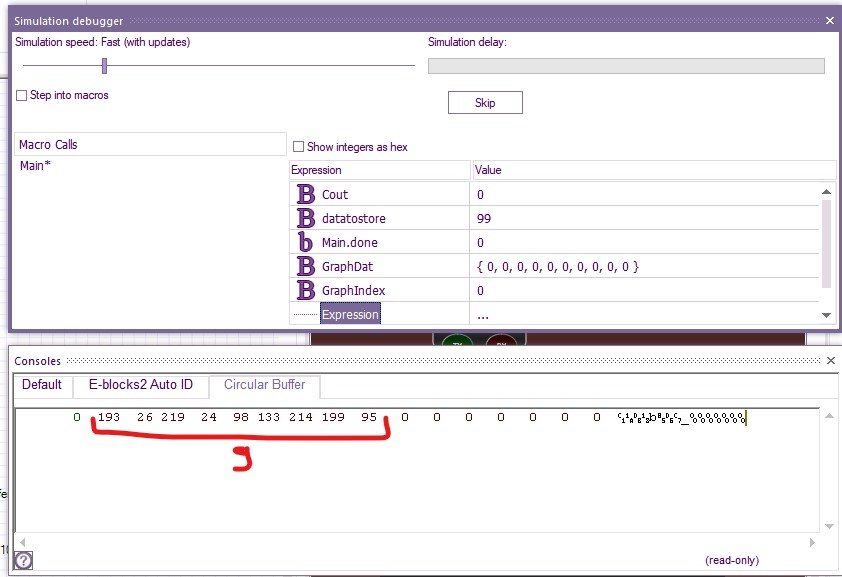

Re: Circularbuffer Getbyte get out wrong data position
I tried with buffer size= 11 for 10 data to store and it work's. (store last X value)
I made another test with size 10 for 10 data to store. (store first X value)
9 data was stored and 1 lost The second point is that the Circular buffer on the Console do not reflect the buffer.
10 data sent, only 9 in buffer but 10 in console. This is unsettling to be oblige to use buffer and simulation like this.
Of course I understand well that need 1 more Byte (empty byte) to be able to rotate previous byte ,second byte, etc... But like I said, this must be done in background.
For a buffer of 128 byte, 0 to 127=128 bytes but need 1 more byte (background byte) to store the data during the shift of the register.
I used many FIFO of LIFO in Industrial Automation and the size is always the exact qty of data to store. Because we do not allocate the memory for the Buffer, so it will be better to be able to store X bytes in a X byte buffer.

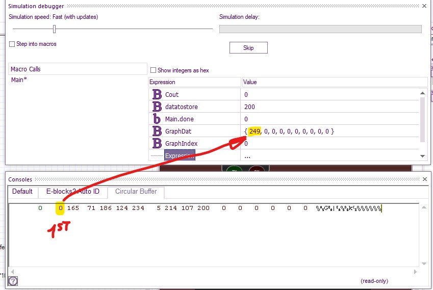

Hi, what are the news about buffer problem, still no news since end of December?
(Need to setup the buffer size to nbr data to store+1)
This causes another issue :
When discard buffer with get array, oldest entered value is never discarded !
1st test
- Buffer size5, 8 bytes to enter in buffer, 4 Bytes to discard with GetArray --> the oldest byte value who is 4 in the simulation stay in the buffer
2nd test
- Buffer size5, 8 bytes to enter in buffer, 3 Bytes to discard with GetArray --> the oldest byte value who is 4 in the simulation stay in the buffer
then at the next first Buffer PutByte, the oldest byte is overwrite !!!
Please check ASAP, it's already difficult to work with data so if in addition, the buffer doesn't work, it's a nightmare!!!
