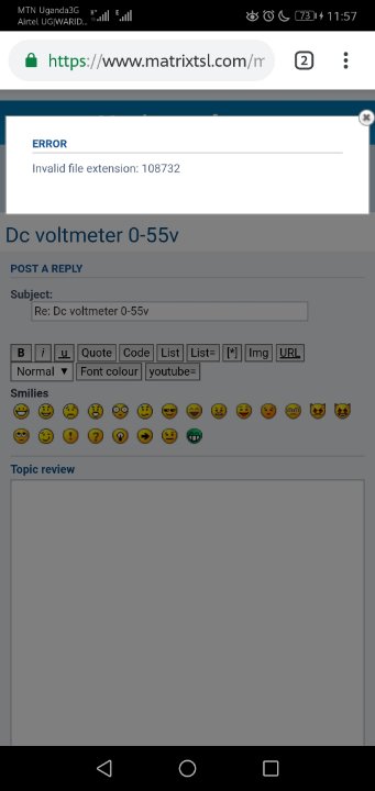

Can you post a screen shot of the error and of the file name + extension of the file you are trying to upload?
Derrihj
Posts: 348
Joined: Mon Jul 09, 2018 12:43 pm
Has thanked: 67 times
Been thanked: 33 times
Re: Dc voltmeter 0-55v
Post by Derrihj »
There is the sreen shot
