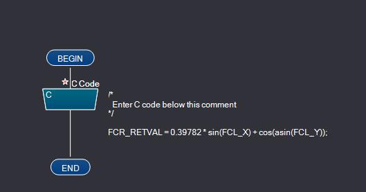

Hi MJU,
Flowcode renames variables to either FCV_NAME or for locals FCL_NAME (where NAME is the name you gave the variable converted to upper case)
To define a float - declare the variable as type float
(An aside - note that due to a bug in FC - you must do this when initially declaring the variable - although a variable type can be changed - float becomes grayed out and can't be selected (might be possible to change the XML def though - which could save some heartache if you've used the variable in a lot of places :-)))
You can access these in a C block (you must use the FC modified names in C code) A useful tip is to view the code as 'C' - to see the names FC has used.
Formula.fcm
(633 Bytes) Downloaded 286 times
Here I created a new macro with x and y as (float) arguments and returning a float (return value is referred to as FCR_RETVAL)
If using C 'inline' you can also assign to FC variables (FCV_X = 1.234; for example)
Note that I've modified the formula you pasted - which is not correct C (or indeed math) - suspect just a typo.
Note also that C statements need a terminating ';' (semi colon)
Unfortunately sin cos etc don't seem to simulate but should compile and run (?)

Your code seems to simulate OK - remember to turn on C Sim - it sets return to 1060.1544189453125 (which is correct given the accuracy of floats -
see https://www.learncpp.com/cpp-tutorial/f ... t-numbers/ for some detail on this)
However - the result you should see on the LCD will be 1060 - because PrintNumber takes an integer argument - so the float result is converted to an integer before being printed. You could convert the value to a sting using FloatToString$ before using PrintString.
Note that you don't need to give the variables uppercase names - flowcode capitalizes them for it's 'internal' use - so if you want to access them in a C block you need to be aware of this.
The FCV_ prefix is used for global variables FCL_ for local variables.
