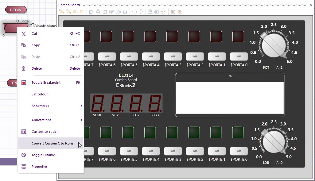

How to convert C code to Flowchart icons
Flowcode can convert C Code into Flowchart icons by using the Convert Custom C to Icons, right click menu item.
Multiple C Code icons can be converted at once by dragging the mouse or by holding control and left clicking on icons to select multiple icons.

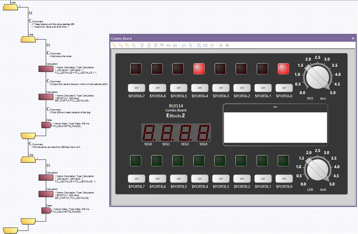

Example
Here is an example program that counts up and down in binary using Port A and a Combo Board component to show the LED signals.
Here is the file before conversion to Flowchart icons.
Here is the same file after converting the C Code into Flowchart icons.
