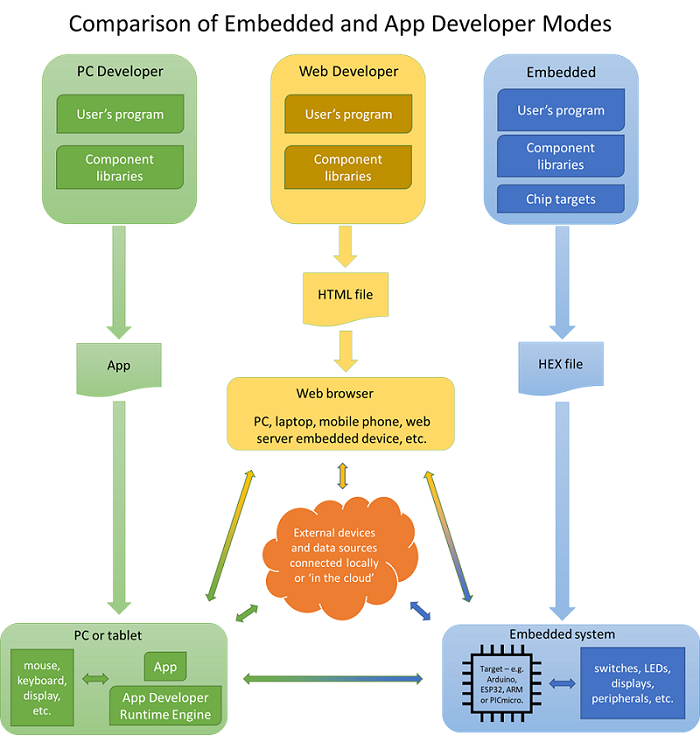

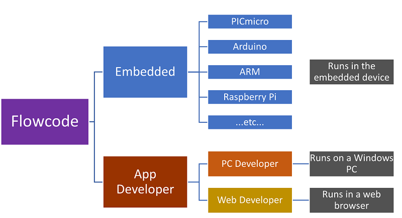

App Developer is comprised of 2 distinct features – PC Developer and Web Developer. Whereas Flowcode Embedded projects are developer to run on the embedded device itself, App Developer projects will run on a PC or within a browser and will typically be used to communicate with remote embedded systems.
There are a lot of similarities in how Embedded and App Developer projects are developed. The main difference is the actual intended target device. Embedded projects are used when the target will be an embedded device such as a chip or a single-board computer. PC Developer projects will create apps that run on Windows PCs and Web Developer projects will create web pages that can be run on any PC or device that supports a browser.
