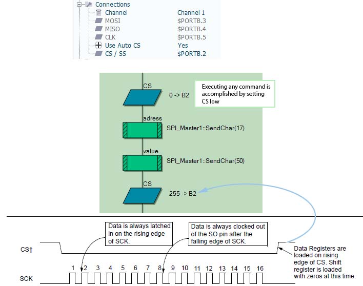

Re: arduino and spi on software
Commands
- digi_pot_commands.jpg (65.85 KiB) Viewed 26518 times

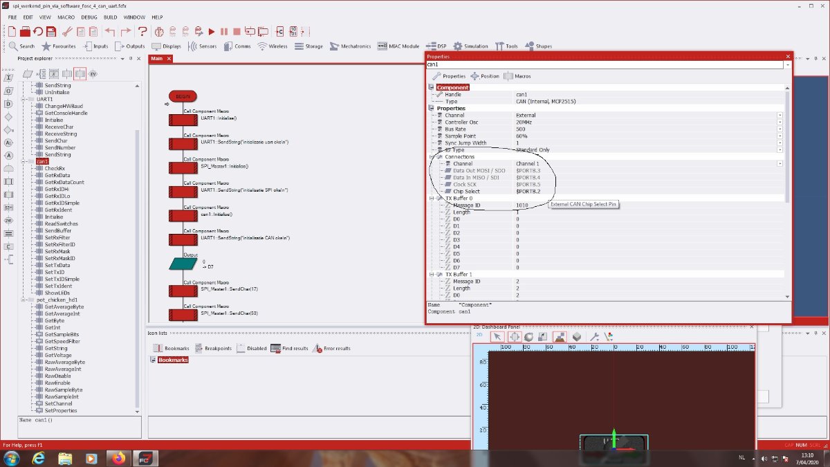

HI
I use B2 to control the cs line for the SPI connection between the Arduino and mcp2515 can controller.
- can.jpg (126.46 KiB) Viewed 26473 times

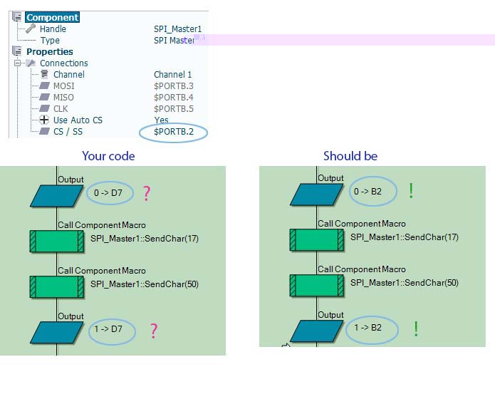

Please have a look Ruben.ruben_1989 wrote:HI
Flowcode does the CS/SS line setting for you as B2.
However in the code the B2 is not controlled.
- Line CS not controlled-2.jpg (59.69 KiB) Viewed 26453 times

that you have chosen the SPI CAL component?
What is CS/SS line port you have used in SPI CAL component? Is it B2?
