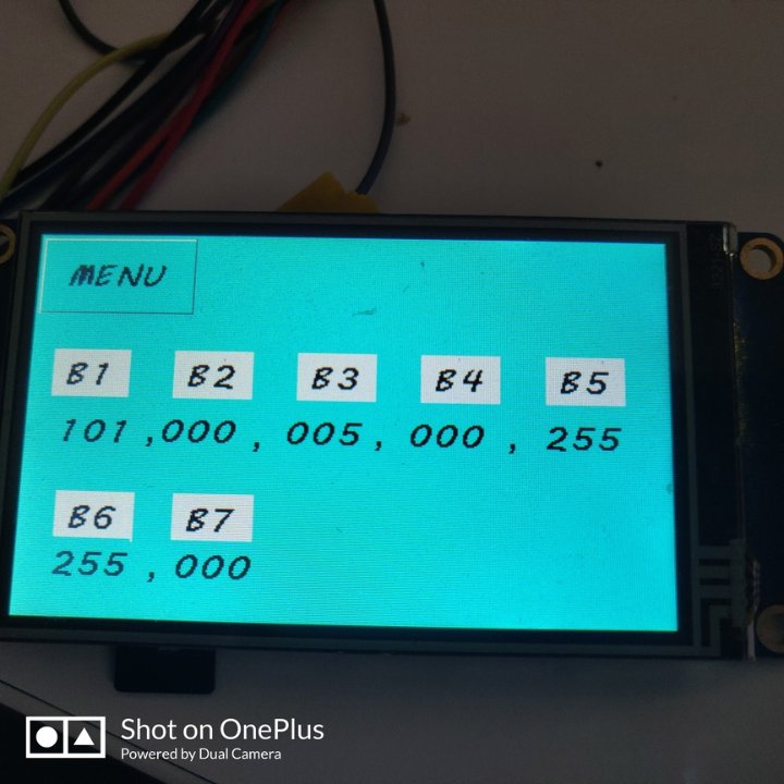

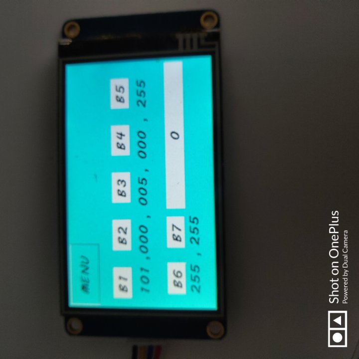

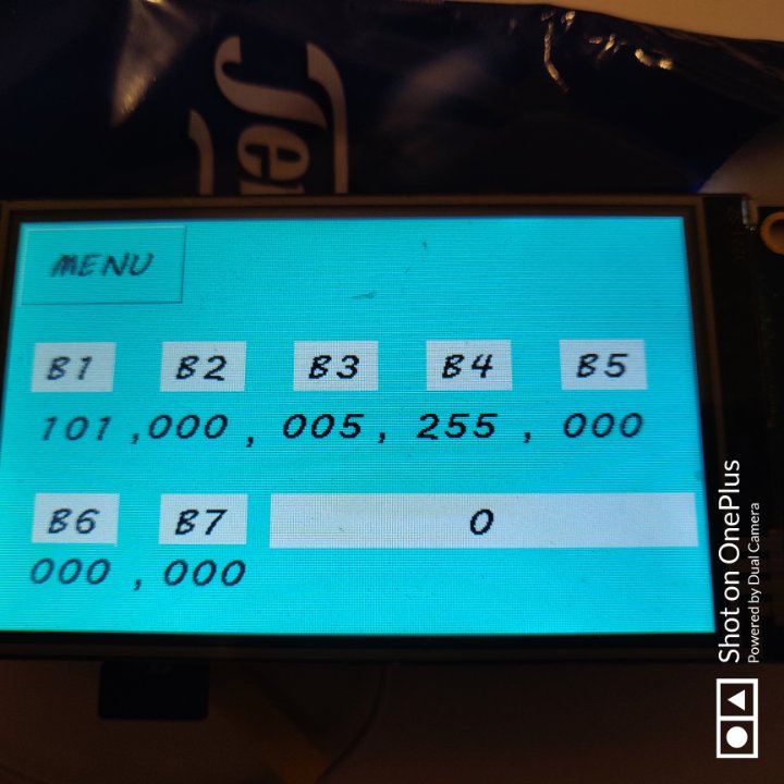

I would like to present you the problem that I encountered using the STM32F407EV chip, which concerns the interrupt on the RX pin of the serial port 232, in previous experiments I have always used arduino mega2560 and with your advice I had always solved about the RX interrupt, now I wanted go to the STM32 platform, the circuit is composed of the disply touch which sends the commands of the keys via the serial port, the card recognizes them and sends the command to view the next page, pressing the menu key enter the 7 byte sequence from the display that identifies the key pressed (in decimal 101 00 05 00 255 255 255) as seen from photo 1 of the analyzer, but using stm32 the displayed data are all mixed (photo 2), while using arduino they are in the correct positions, even if it is always missing the last byte (photo 3).
in the program I also put a led that activates when it enters the data capture routine and in the STM32 it seems to work for a single touch and then hang, while on arduino it continues to receive.
The program is the same for the 2 platforms
why this? do I use a wrong method to detect data? do you have any examples to do better?

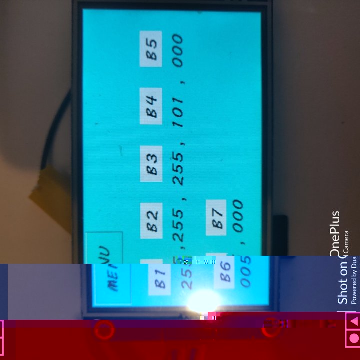

I have had the opportunity to try the circularbuffer and I see that it only partially works
the data is only partially collected, I have already tried several time outs up to the maximum, the cleaning block does not seem to work and does not reset the stored data
short description of the program
1) when I press the menu button I send a series of data from the arduino display that I collect via RXint (see screenshot) and store it on circular buffer
2) check that the first data stored is 101 if it is correct I call the macro show and display the data stored from address 0 to address 6 and display them from B1 to B7, data B1-B2-B3 are correct, B4 is wrong , B5-B6-B7 are missing (see photo)
3) on returning I clean the memory
4) after a delay to display load at 0 i the variables from D1 to D7 and display them, in reality as seen from the video the data alternate from 0 to the previous value.

I think the problem is that if you don't immediately get D1=101 then you print 0 and wait a second.
You need to synchronise with the incoming stream of characters.
You probably need to use WaitForValue() or loop with GetByte() waiting for the 101, then wait for GetNumberBytes() to equal the number of bytes you are expecting, to ensure that the rest of the stream has arrived in the buffer. Then you can read the values.

attached the file that I made to read the incoming bytes on the serial, on arduino it works well, (this is the only way I managed to do) as you can see in the photo I read correctly the 7 incoming bytes, but the same program does not work on STM32. in STM32 I read the B1 (value 101) replicated on all 7 bytes, also I have almost the certainty that the flushbuffer block does not work 100% as it does not clear the buffer, while indexing correctly
