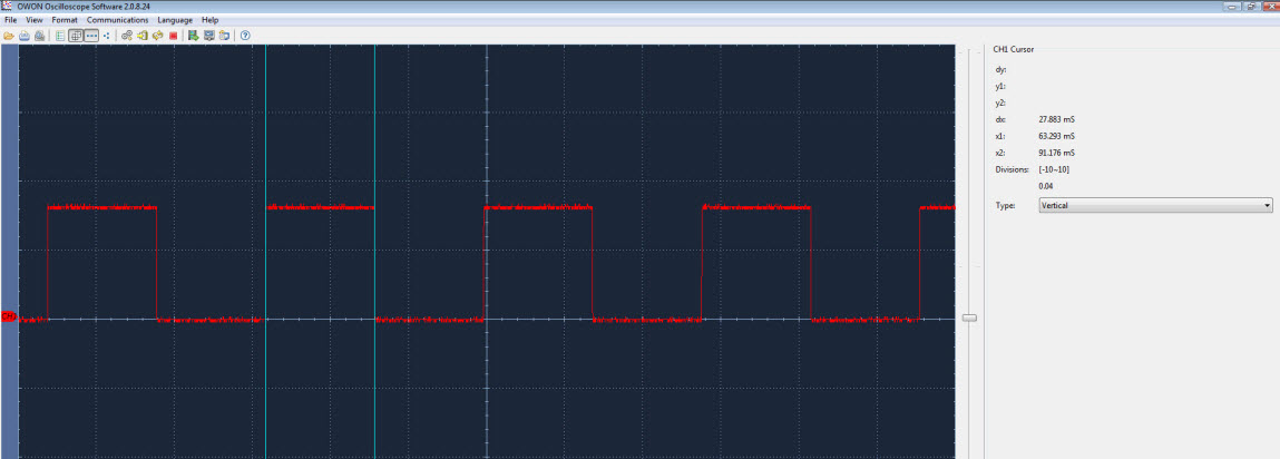

I configure the Clock setting on a dsPIC33EP by including a C file in a macro then call the macro at the beginning of the Code or flow diagram (it is the fisrt function call)
this code get never execute as you will see that my Timing is running 3 time to slow.
I tested this by setting up a T1 interrupt at 100Hz = 10mSec I read in the scope ~28mSec
see screen prints 1&2
The I just deactivate macro and place a C call components with the same code as in the macro then the Timing is 100% (10mSec)correct see screen print 3&4
I did not look into the generated C code to try and see why this is happening .
I guess my question is it not possible to call c code from outside the main Flow diagram ?
Thank you for helping me understand this

C code calls are allowed anywhere. I have used C code in macros without any issues.

Re: Problem with setting dsPIC Clock Speed to 140Mhz
I can't think why the C code would work in main and not in a macro, I've seen issues before with the PLL not locking but code without dependencies that works in one place should in theory work anywhere.
Could you post your C code and we could have a look to see if it's something that maybe could be improved to be more reliable?
Please try changing the code from this:
To this.
Hopefully it should then be more reliable as your waiting for the PLL to lock before continuing.
Also if you are using 8MHz crystal then the PLLFBD value should be 58 not 68 to give you 70MIPs or 140000000 Hz clock speed.

Ben
Thank you very much I will do as you advise.
I am just not on the same page with you with the 58 setting it depends what you use for N1 and N2 in the PLLPRE and PLLPOST(in my understanding) also M is 2 + the value you write to the PLLFDB ,I use 0 and that is always 2 in each of them then FOSC = XT*M/N1*N2 or do i misunderstand the datasheet
then I get 8*(68+2)/2*2 = 544/2*2 = 140
Hi Benj
Just a feed back I added the lines of code as you suggested that helped in the sense that I could use the macro call and the controller would run however it did a few times not start to run
after discussions with Microchip Field application engineer I had to include a while loop that checks for the PLL lock to happen with this added the micro start every time no problem at all
does this make sense to you ?

This what I used based on the Microchip examples. It appears that the WDT PLL Lock wait which Benj has included in his C code can also be set in the chip config if the WDT is enabled.
