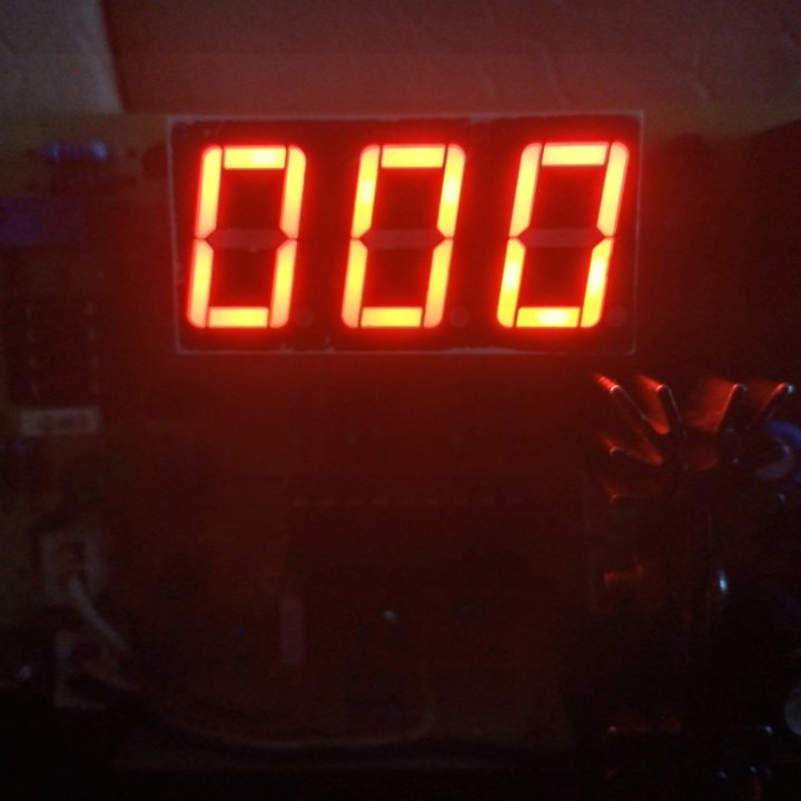

Hi every one,Ever since Benj updated the common cathode 7 segment to allow for a HIGH on the output i really wanted to test this and see the new tricks Ben added, i really like the part that says (common Type) were you get to choose if you are gong to use a high or low on the output and also there is ZERO half lit LEDS as you can see my images below, Thanks Benj.So i designed a simple circuit which happens to be an auto Sanitizer, my goal is if an object comes close to the IR-LED/Photodiode pair i get an output on the LM358 which in turn gives me a LOW signal on RA5 of 16f88 through an NPN transistor.Now with a LOW on RA5 variable object is no more equal to ONE so a 1 is added onto variable named PERSON which is also displayed on the 7seg, and then sanitizer is activated to sanitize the user.But i don't know if am doing something wrong because my variable PERSON is raised to 1 before RA5 becomes LOW and keeps on raising without a low on RA5 please take a look at my flowchat and see if am doing something wrong and at this point, the != , <> (NOT EQUAL TO) command don't seem to work correctly.This project is to record upto arround 998 people being sanitized and it will have a record keeper thanks to the Eeprom and many more that it will have to do but now it's still basics with few tasks.

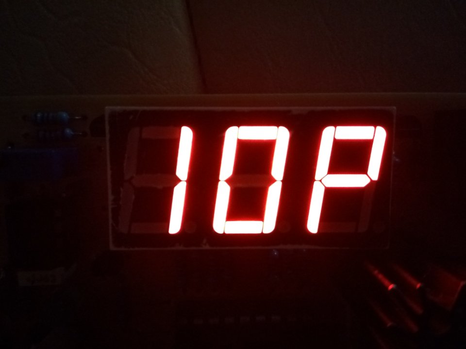

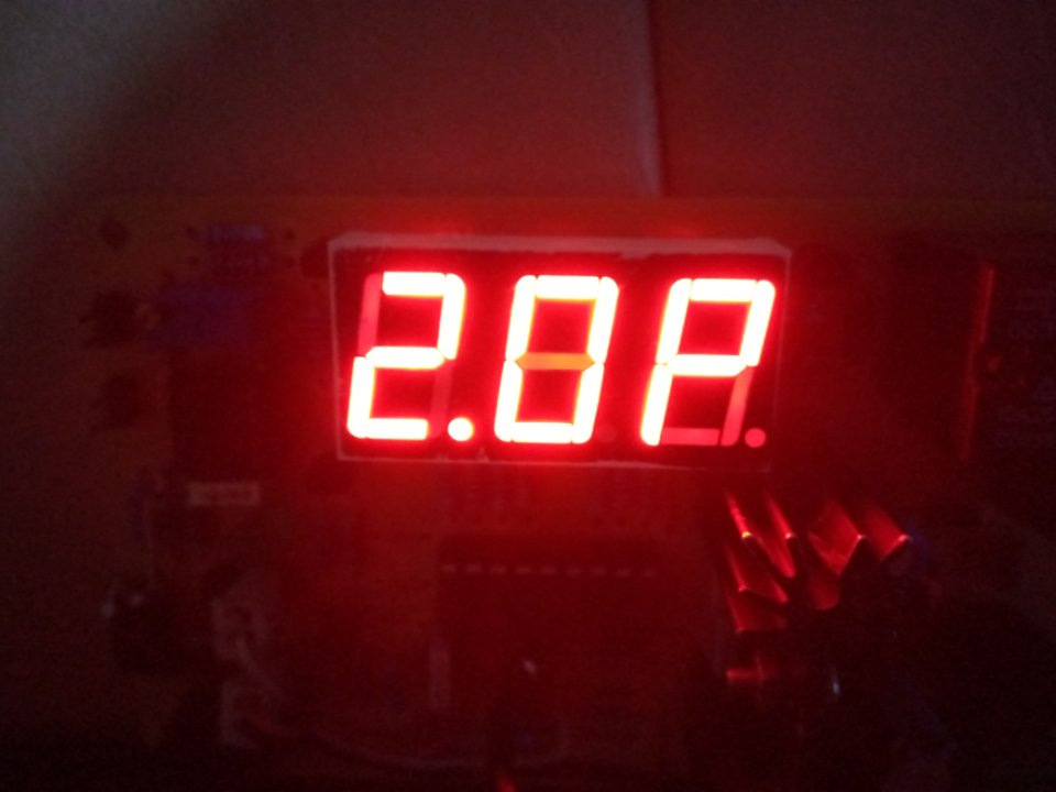

Ok ive added custom characters, that is PE (people), on Start up display shows 0PE (0 people),now as an object comes close to the sensor, a 1 is added then display shows 1PE (1 person) and so on as the count comes to 10 and above it changes to say 10P, 20P, 99P then 100 without (P) upto 999.Now the code works well in flowcode but on Hardware it doesn't please take a look at my flowchat and help find the "BAD guy" in my code thanks allot.

At first i used a decimal point to separate the zeros from numbers of people like 1.00, 2.00, 10.0, 99.0 and then 100 till 999.and the program works very well after Martin told me to use <>32,But now i wanted to replace the decimal point with characters like PE that is 1PE , 2PE, 10P, 99P and then 100 til 999, but when i load the code into the chip i get a funny display with no increasing numbers even with the object close to my IR-LED/Photodiode sensor pair.I get a funny display which is shown below.Remember my PE character is now sitting in place of the two zeros in case of (ones) and only a P in place of the one zero incase of (Tens) which should work exactly as in the first place with the zeros in place but it doesn't.

Ok i managed to work it out and now it's working with my characters after making seg1=1 instead of 0x73 ,seg2= 2
instead of 0x79 and a 2ms for each digit update interrupt having a total of around 165 flames/sec all together to minimize on the half lit led on my Characters as the reference 1 and 2 was reflecting allot on my characters so reducing the interrupt frequency to 165 helped reduce on the intensity of the half lit led. Using component macro takes more space BUT produces better display with totally zero half lit LEDs, so my conclusion is that if i want better display with totally zero half lit LEDs it's better to use the component macro for the digits common pin triggering and a spacious MCU but also the output port masking method helps when you are in a dangerous low mcu space "front line" haha. So using the output port masking all my code was able to fit it the 16f88.

Ok i have managed now to make my display look really beautiful with totally zero and i mean totally zero half lit LEDs even with port masking method, this is a great achievement for me as i don't have to use the component macro that take allot of my MCU space. I have managed to do this by clearing all port bits used just before the next digit to be displayed on each 7 seg Digit.I tell you i now have a nice and beautiful display that don't irretate the eyes.

Totally zero half lit LEDs only a reflection of a close camera.
