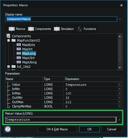

These are the functions: The map function is intended to change one range of values into another range of values.
Example 1.
Output from a temperature sensor is in centigrade.
you can map it to give the result in Fahrenheit.
To do that set: InMin to 0, InMax 100, OutMin to 32 & OutMax to 212 & ClampMinMax as 0: With ClampMinMax = 0 then the input is allowed to go over 100.
For example if the temperature sensor is at 120 deg C the value of the variable going in to the map function will be 120.
The returned value will be 248.
If you don't want a higher value than OutMax then set ClampMinMax as 1.

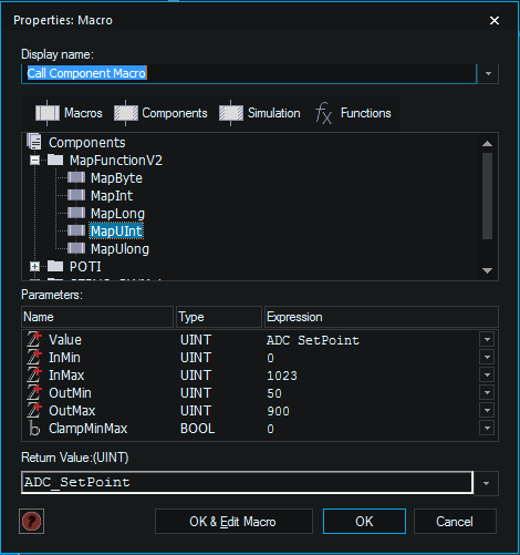

Example 2.
You have a pot which produces ADC from 0 to 255.
You want to convert it to 10 to 100 as you don't want PWM to drop below 10%
To do that set: InMin to 0, InMax 255, OutMin to 10 & OutMax to 100 & ClampMinMax as 0
You don't need ClampMinMax at 1 since the pot value will not be below 0 or above 255

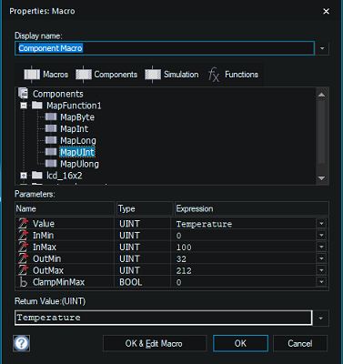

Can you check you have the variable showing outlined present:
You're welcome.
Re: Map Function for any target device.
yes i checked
- map is not working.png (14.95 KiB) Viewed 15223 times

Can you post your flowchart please,
I will look in to it.
I have just tested it and working for me: I have attached my component just used, for a comparison.
The variable for Input Value is not showing the underscore.
That should not be allowed.
Unless its just the image not showing the underscore?
Edit: Not working correctly as ULong is required instead of UInt.

Hi panuj417,
The component is working OK.
Can you try using the ULong rather than UInit
I did not test thoroughly enough earlier.
Sorry about that.
Sorry about that.
