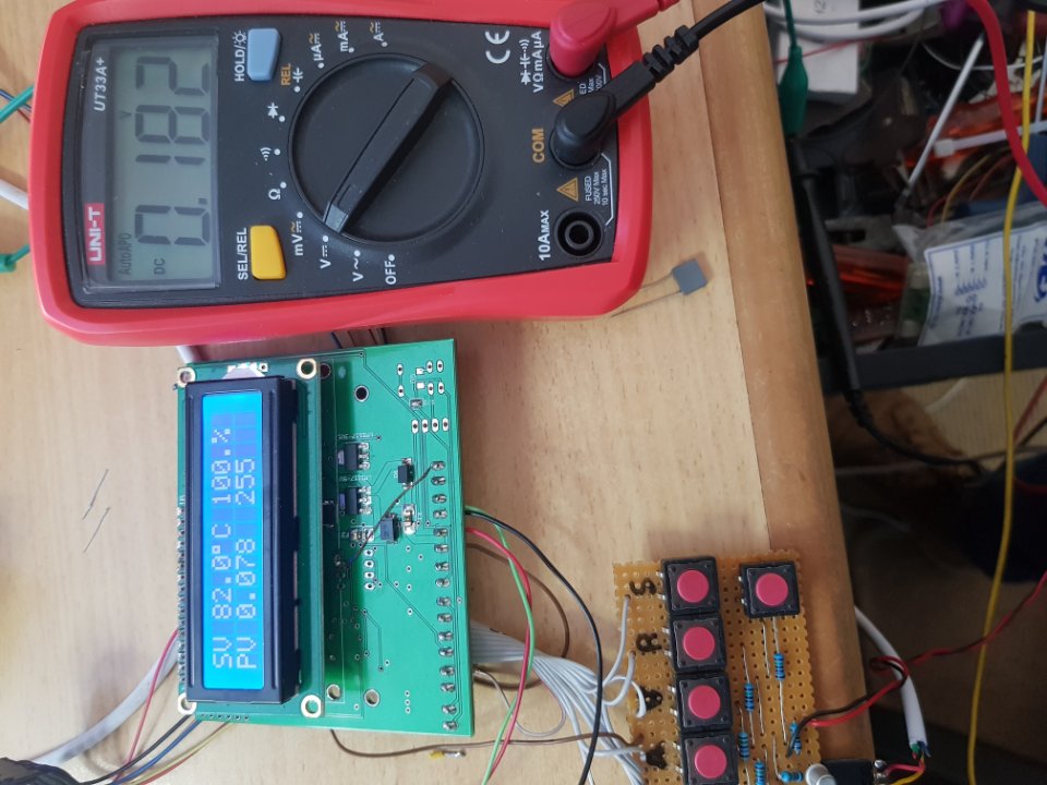

Im not sure if this is still part of the problem with the A/D component not working correctly. On A0 I have a voltage of 0.182 which im trying to display on the LCD screen. I'm using (get analog voltage) and then converting it to a string then printing to screen but what it displays is 0.078 and sometimes flashes 0.182 it looks like it is not reading the correct voltage every time not sure if its me that is doing somthing wrong or there is a bug still in the PIC18F47K40.
I would like to get this resolved as soon as posible as i need to test this over the weekend

Maybe try a slower conversion speed and see if that helps, might be a touch too fast at the current clock speed, also do you have any noise present on the ADC pin, Maybe a decoupling capacitor to ground or a full R/C filter to help some noise rejection?

Post by jollybv »
Thanks for your reply that seems to have solved the problem I set it to Focs / 128, now I need to get the PID side of things working (tried buying a PID controller but with this Vuires cant get much here in SA)
