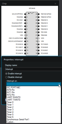

Just looked at the chip in flowcode, and see that it only shows 3 timers 2-4 and 6 ,am I missing some thing in flowcode.?
Regards Roy.

We maybe on crossed purposes.
I thought as you mentioned PWM you are referring to CCP PWM.
Now I know you are referring to timer interrupts, loads of devices has more than 4.
The 18F24K40 was just a random device.
These are the timer interrupts:
Timer Interrupts 18f24k40.png (49.53 KiB) Viewed 2435 times
There are things to consider before ordering chip.
E.g memory and pins, I may be able to find a more suitable device.
The interrupt don't work the same so more details are required to determine if suitable or not?
Also its best to create and compile a flowchart to make sure compiles ok with the required target device.
