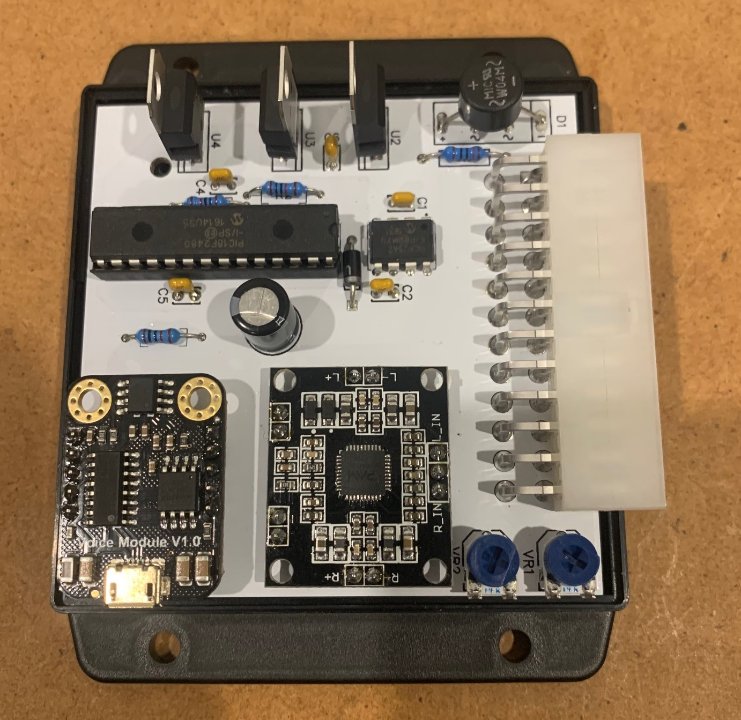

Finally I've been able to spend a few hours on this today and it all works as expected.
Also put together my prototype to see if there was any noise induced by the environment it'll work in, all seems good so far.
I still haven't figured out how to use the mask/filter settings properly...
Any advice or improvements to my program are very welcome
I'll finish this one off this week by making it a bit more compact and send it off for testing and compliance, then i'll move onto the next CAN based project next week which will save me about 8kg in wiring and halve the current consumption.
thanks Benj for pointing me in the right direction on this project, i'm sure i'll have more questions on the next project.
Cheers,
Hooz
