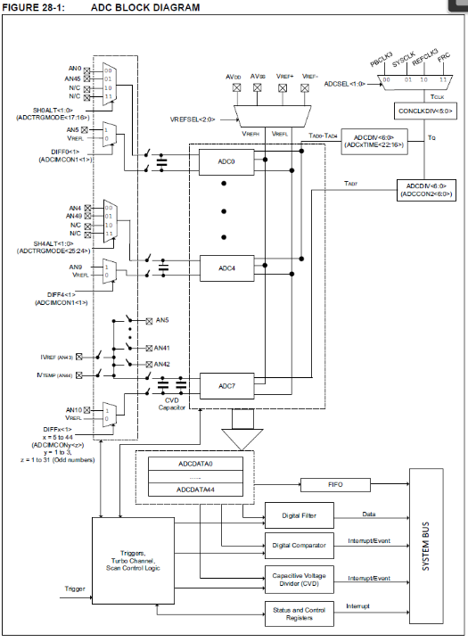

AN0 - AN4 are connected to ADC0...ADC4
AN5 - AN44 are connected to ADC7
there is no ADC5 or ADC6
and I'm not sure if all the result can go to ADCDATA0

Yes that block diagram is very confusing but I beleive it is showing the ADC trigger pins and reference pins not the ADC input pins. ADC0 should be able to connect to all ADC input pins and then the result will go into the ADCDATA0 register.
Let me know regarding the ANSEL.

Not all AN are possible and it's not ADCDATA0 it's ADCDATA7.
I trie to explain..
The Pic has 49 AN Pin (Analog Pin) and 6 ADC (Analog Digital Converter)
ADC0...ADC4 are fix for AN0...AN4 with an alternate AN Input (microchip call it Class1)
The command is to choose the alternate input:
ADCTRGMODEbits.SH0ALT = 0; // ADC0 = AN0
ADCTRGMODEbits.SH0ALT = 1; // ADC0 = AN45
ADC5 and ADC6 don't exist
ADC7 can be used for AN5...AN44 (microchip call it Class2)
The command is to choose the AN input:
ADCCON3bits.ADINSEL = 22; // working for AN22 on ADCDATA7 !!!!
