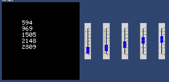

The simulation is working fine.
In the hardware its' showing for all the AN signals the value from AD0. If I change the paramter from AN01 Vref to 5Volt
it' shows the the value still from AN0, but in the range of 5 volt.

I changed the board. Now I'm using a PIC32MZ2048efh100
In the simulation all the 5 analog channel are working fine.
In the hardware is just the AN0 working. The bad thing is that the value from AN0 is showing on all the 5Channel in the display.
I suspect flowcode does not switch to the correct analog input, it's always remains on AN0

Re: Analog input not working on PIC32MZ2048ecg100
Hello Stefan,
This could mybe be an ANSEL register problem? Please can you try the following code in a C icon and see if it makes any difference. CHange the register name and bits to match the ADC inputs you're using in your program.
If this works then I should be able to sort the component so it generates these calls for you.
ANSELBbits.ANSB0 = 1;
ANSELBbits.ANSB1 = 1;
ANSELBbits.ANSB2 = 1;
