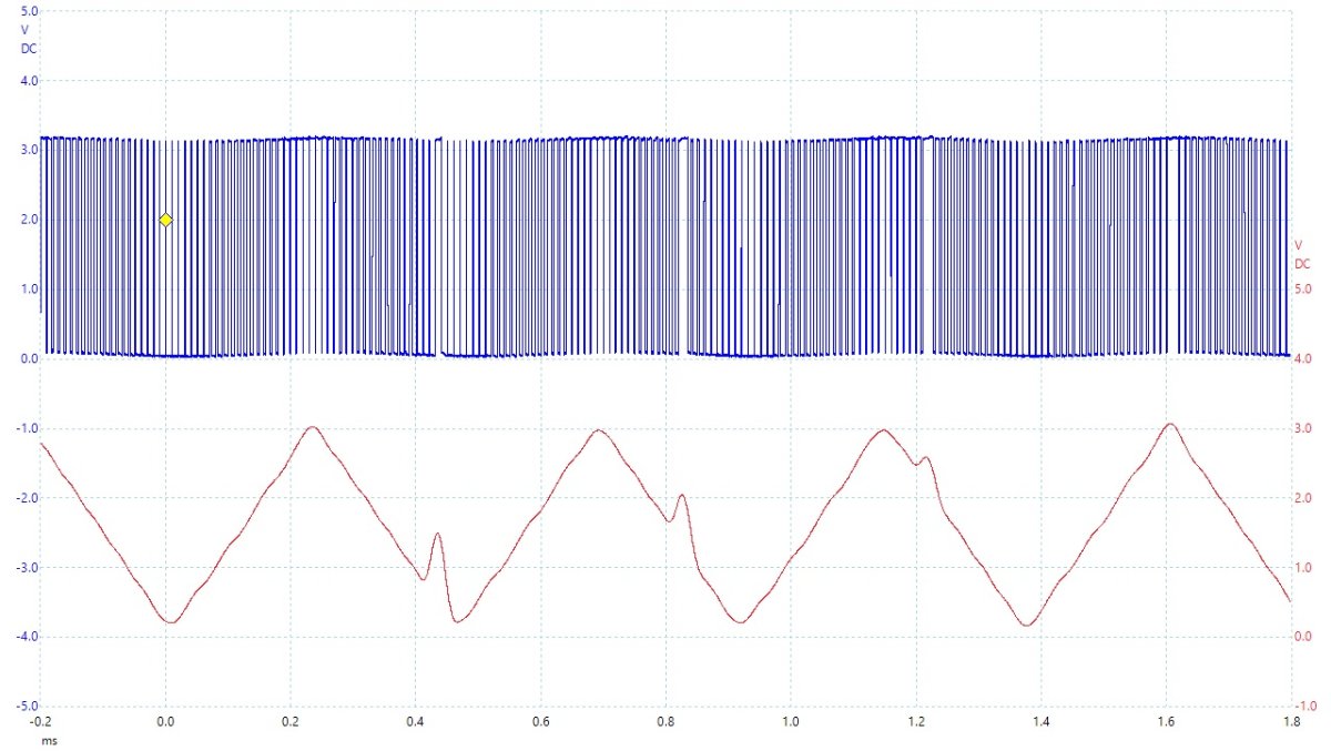

I am trying to use the PWM outputs form the dsPIC33EP32MC504 to gernerate various waves from data stored in a LUT. In general it works very well, however I seem to be getting glitches on the falling edges (aways seems to be on falling, and never rising).
As you can see in the triangle wave example, as the PWM duty is reducing, for some reason the duty glitches in the high state so stays on longer than it should (never in the low). The glitch also seems to move accross the peroid of the waves on a sort of pattern that repeats every few periods.

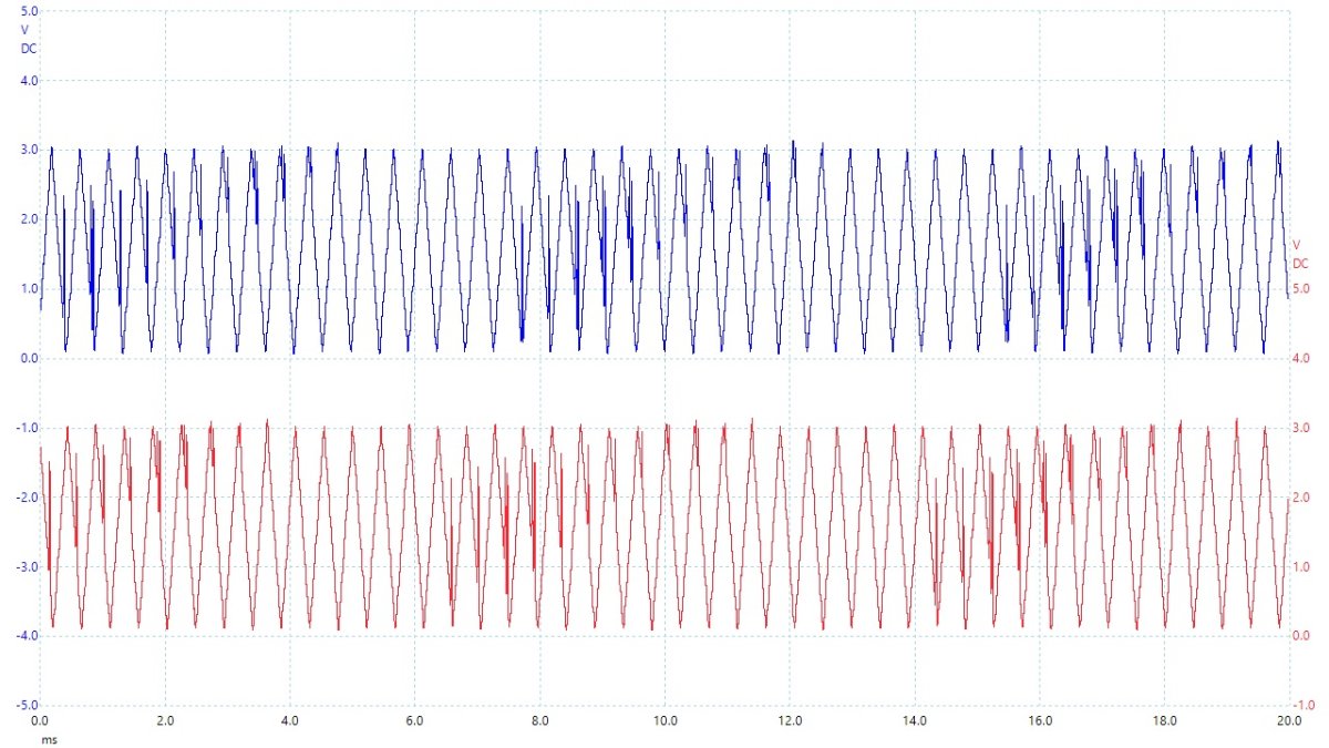

I have added two examples. One where you can see both the PWM generated and the trianlge wave (the same signal but run via a filter). The other one is a sample of two different PWM modules filtered running together and showing a similar patten.

Re: PWM issues
I've seen these glitches before. It basically happens when you write a lower duty but the timer has already couted past the value you set. And so instead of immediatley outputting low the output remains high for the rest of the period.
When writing to the PWM duty try resetting the timer count register to 0 using a c icon and see if that makes any difference. I might make this part of the component CAL code if that is what's happening to save this problem appearing again.
Re: PWM issues
I've pushed a change to the update system that should solve the problem automatically for you.
This is the fix I have implemented when changing the duty.
Let us know how you get on.
