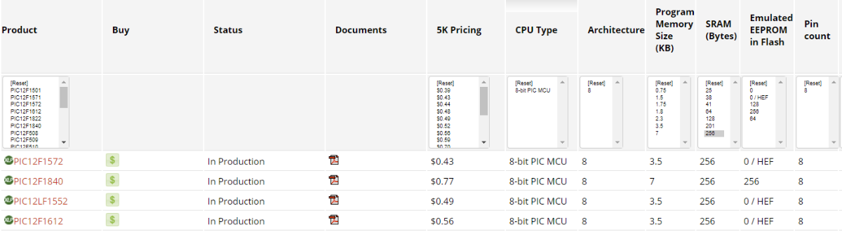

This PIC has very little ram maybe you can switch to one with 256 byte
Here a link to the 8pin 8bit PIC.
https://www.microchip.com/ParamChartSea ... nchID=1001
stefan

But you don't have much ram left, with one or two 16Bit more is the limit. A byte need 1Ramplace an integer need 2Ramplace.
Is a 16Pin PIC an option?
