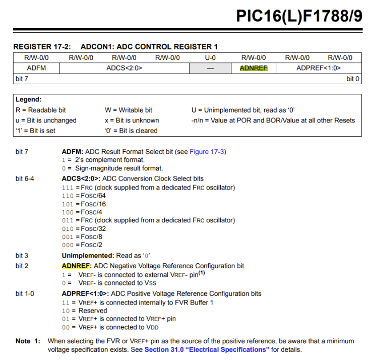

I guess you have to set the ADC Negative Voltage Reference Configuration bit to 1.

I'm not sure if Flowcode supports the selection for the Vref negative (ground) pin for the ADC.
You must first initialize the converter with FC and then change the bit.

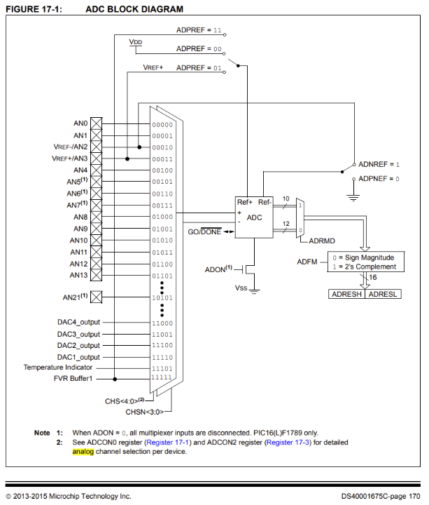

As default, Flowcode uses GND for -ve reference and VDD as positive reference.
Within ADC properties you can select Vref+ pin so then the two references are Vref+ pin and GND
If either does not work then could be a bug.

Martin, thanks for chiming in. As I understand it, if you select external reference (ref+) in the ADC setup it also automagically sets ref- to an external pin, not to Vss. In my case I route both ref+ and ref- from the source to the controller board to be sure I do not pick up any DC offset on the way.
But I may be on to something: it looks like the flatcable connecting the two boards is not reliable, and that sometimes the ref- connection drops out or becomes high impedance and the ref- is then only connected to ground all the way back at the power supply and that longish route has a DC offset.
So I believe that is the reason, when I jumpered ref- to Vss on the controller board, the issue was gone. That's the reason why I investigated this ref- business.
Still have to do some testing to confirm. Funny how these things manifest themselves in areas that basically are OK ...

No, it's as i stated:
medelec35 wrote: ↑
Wed Oct 21, 2020 10:01 am
It could be C code you are adding which is causing Vref- to be connected?
Should not require any C code to work with Vref+
Otherwise if no C code is used and Vref- is selected, then its a bug.
