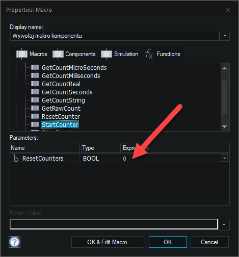

Hi Dionyzoz
Trie this parameter

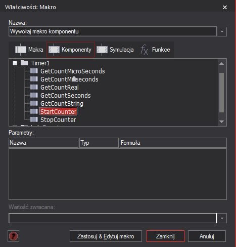

I understand, but I'm afraid the reason is little different.
I have no any parameters to display and modify.

Hi Dionyzoz
Yes it is from FC8. And there is an another error. This second error is just with the timer from your STM chip and not with my PIC32MZ timer.

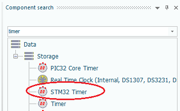

Hi Dionyzoz
You need to use the STM32 Timer component ...

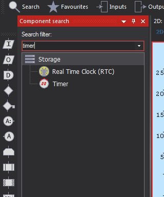

Something is wrong with my Flowcode7
This option looks like this:

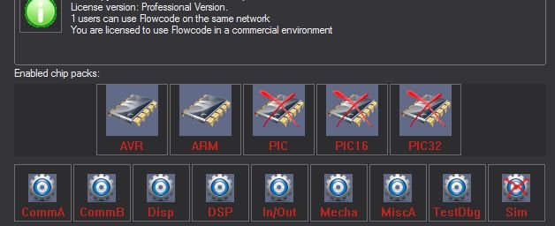

My chip packs are shown below. Should I reinstal it?

Ah, sorry, didn't spot you are using V7
I think this component was done for V8
Not sure if this is available in V7
I will have a look and check with Ben
