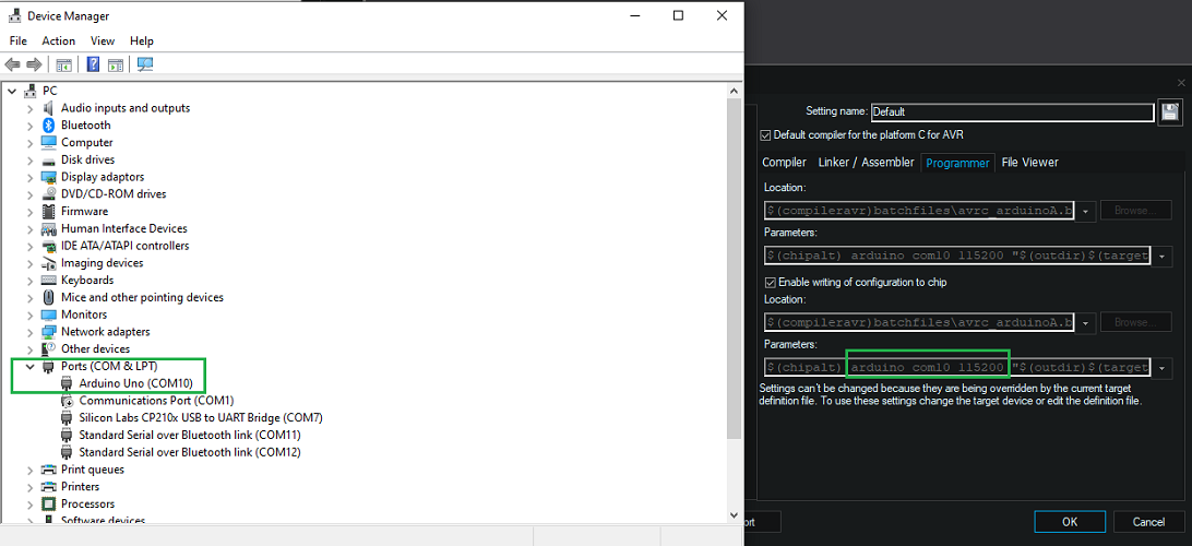

In the Project Options can you check the COM port is correct for the Arduino.
Also can you check the device manager to make sure it can see the Arduino and the USB drivers are installed.

Re: unable to upload code onto Arduino Uno R3
So you know what to look out for here is my set up:
Of course your com port is probably a different number.Martin

I've encountered something similar..
I find I need to change to a different port in FC okay it. Then back to project options and change back to the required port. This can be a problem if there is only the one port ((but I have a couple of bluetooth to USB set up - so I'm always good)
I'm not sure if this is correct - but it seems more prevalent with Chinese clone (ch340) boards. Also if I have multiple copies of FC running with several boards attached.

Hi Chris!
I have sometimes the same problem. Firts time I have made a new project Project or reopen the FC8 and have to program the Arduino I always go in Build > Project option > General option >
click on the programmerport and clik on the port number you see, and then click ok. Then try to program.
Br Jorgen

Other things to check - when programming doesn't work - check the avrdude command in the programming window - is it correct? If it is the correct port (-P comN) and programming isn't working its an avrdude / target / cable / windows problem) If it's a different port to the compiler settings windows - it's a FC problem and the Matrix team co might be able to proffer a fix.
As mentioned the 'auto select' seems a little hit and miss - but changing target to a different port and then back (or if there is only the one com port then changing the target device) has always worked for me... However, it probably shouldn't be necessary to do this 'step'!

- no don't think you misguided at all.. It does seem a strange 'bug' that has been mentioned before in the forums several times. I don't think the cause (hardware/software/wetware) or a real 'fix' has ever really appeared either.
My personal opinion is FC doesn't update the port correctly after an auto-detect. So a manual set is required - but as with many 'occasional' bugs it's hard to prove..

Thank´s Martin. Meanwhile, maybe MM will look at this, could be my explanation could hel Chris.
Br. Jorgen.
Br. Jorgen.
