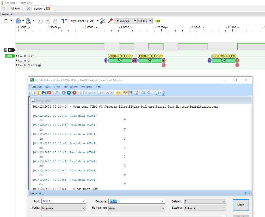

Just started playing whit STM32, I need to have a UART in software mode but
it seems that there is a bug. I am running a very simple code just init the UART and send
a char (53) @ 19200 should translate in ASCII: 5 but the output from the chip
is very strange.
STM32 is running @ 16MHZ and it works fine in channel mode so it not a frequency problem.
How can we fix this, please

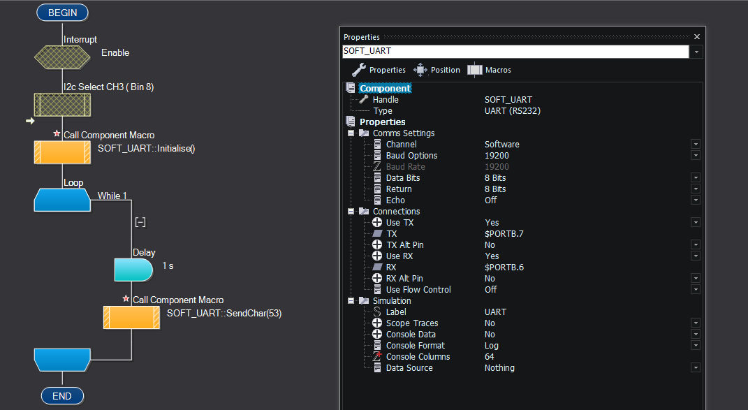

Good morning, Thanks for your reply
Here it is Attached
Here it is Attached

Re: STM32F407ZG Uart ( Software Mode)
Could you please try the attached updated file,
to go into directory ...
C:\ProgramData\MatrixTSL\FlowcodeV8\CAL\STARM
Hi LeighM
Yes, I can confirm It works 100%! thanks very much for your help
