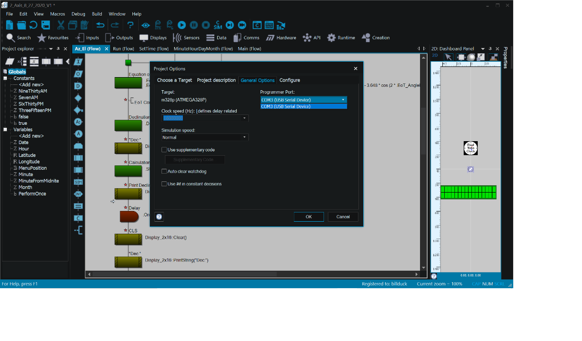

I am surrprized that on the newer laptop and operating system
that when I choose Build / Project options that the dialog is different
in terms of identifyong the port where the UNO resides. See the image attached.

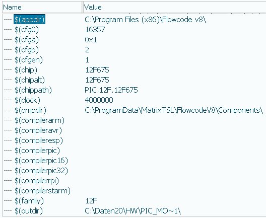

I have also the problem with the toolchain error.
I use Flowcode v8.2.2.15 and the pic8 toolchain picv2 - does this match?
Flowcode and toolchain uninstalled via regedit all entries deleted.
Flowcode new installed without starting Flowcode then toolcain installed (with and without common directory)
... the same toolchain error occures.
Should be an entry by $(compilerpic)? What can I do now?

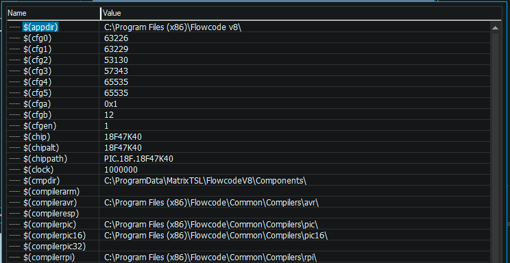

Hi Gerhard,
This is from my compiler options: See if this post helps

Hi Martin,
thanks for the hardcopy with the compiler options.
It helps to compare.
