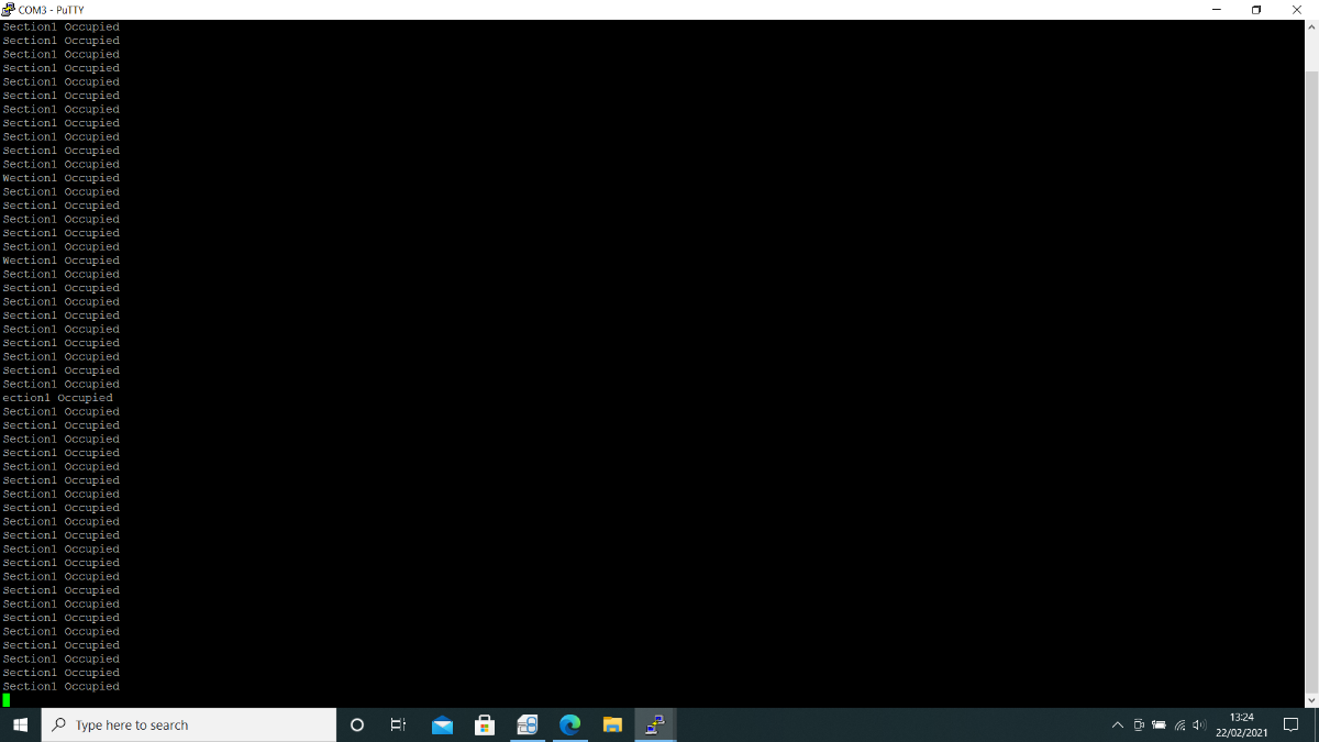

I have created a new program to demonstrate the problem, I have C1 strapped to C2 for RTS/CTS.
If you look at the screenshot you can see it has missed of the initial S once, and Changed the initial S to a W twice.
Hope this helps, or could it be a problem with my hardware?

That's very interesting thanks.
The S character is very similar to the W character in terms of the binary value 0x53 compared to 0x57 which is only a single binary bit out.
I'm curius to see if it's something to do with the flow control. If you turn it off do you still get the corruption occuring?
I'll also see if I can lay my hands on a BL0011 board and try to replicate the problem.
Can you post a link to the click module you're using just to see if there is potentially something wrong creeping in here.
You could also try adding a delay of say 10-20ms after your output icon to ensure the click module gets chance to see the RTS signal going low.

Thanks for your reply, I have removed RTS/CTS Flow control completely from my test program, but unfortunately I am still getting the same issue, with the first character not being sent, only occasionally.
