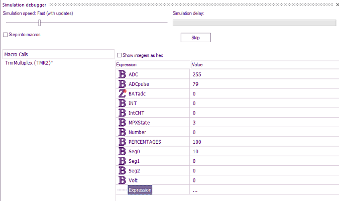

As for the displaying the 10.
Whenever I create a flowchart, I always add variables to the Simulation debugger
Especially if not going as expected.
I did that to your flowchart:
Simulation debugger.png (51.78 KiB) Viewed 11925 times
I could see straight away the variables don't look right.
Look at Seg0 for example, they should only be numbers from 0 to 9.
Also Code profiling (Within Debug ribbon) is useful as you can see which icons or accessed and which are not.

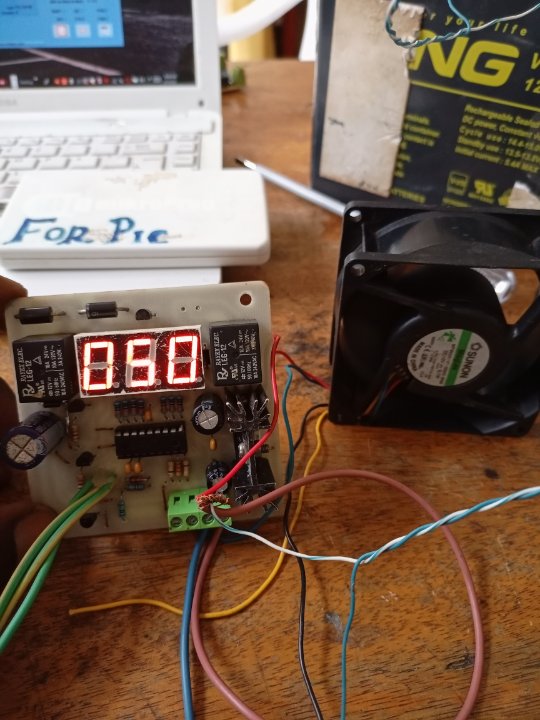

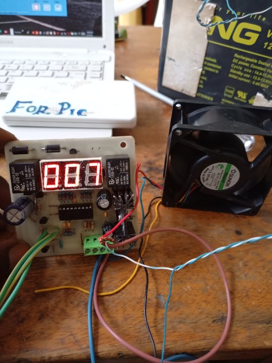

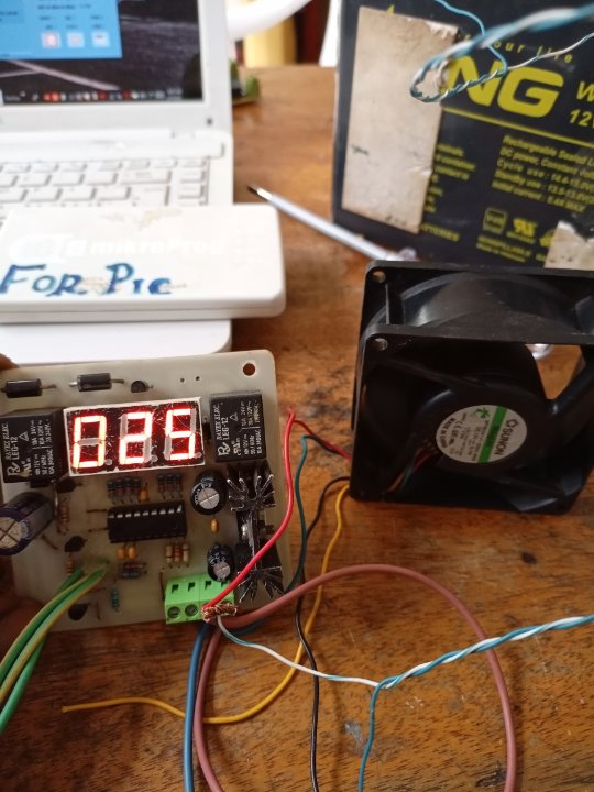

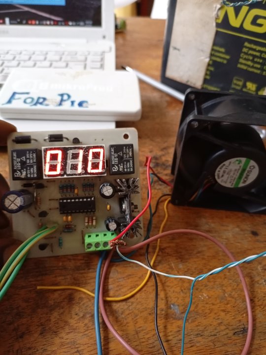

And more pics upto 100% thanks to everyone guys.
Derrihj
Posts: 348
Joined: Mon Jul 09, 2018 12:43 pm
Has thanked: 67 times
Been thanked: 33 times
Re: 4-Wire Fan PWM
Post by Derrihj »
Clear pics

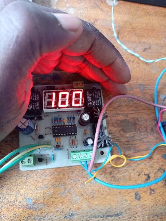

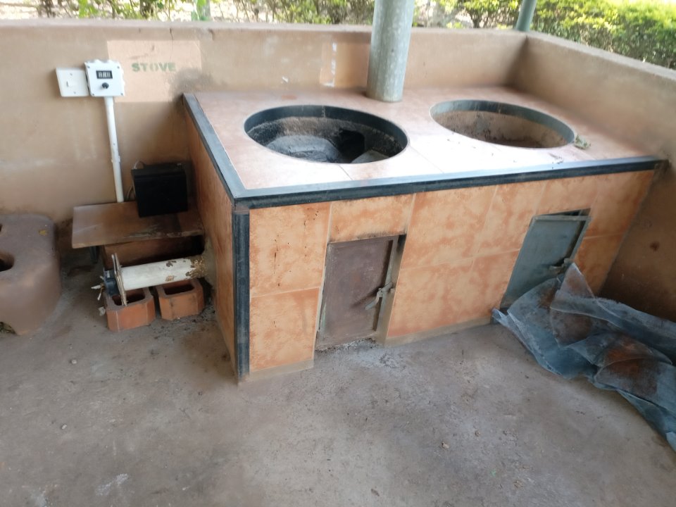

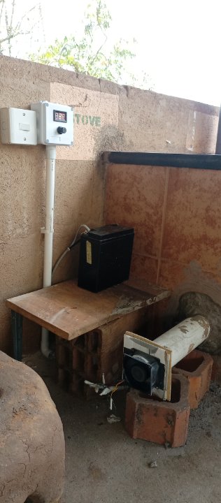

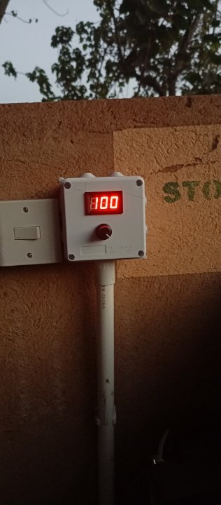

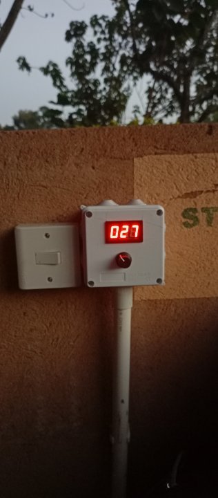

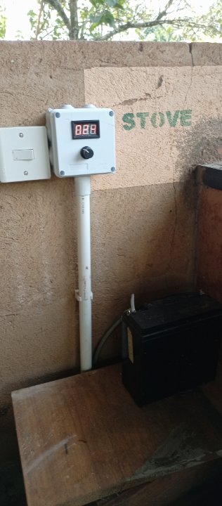

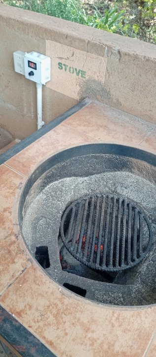

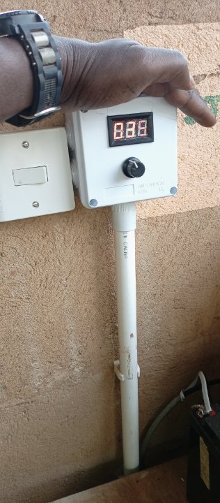

Just finished my project that i designed for some "NGO". It's a local stove with a fire size adjuster, as you increase the PWM of the 4 wire fan the fire increases there by cooking very fast and vise versa. take a look at the finished product.
Derrihj
Posts: 348

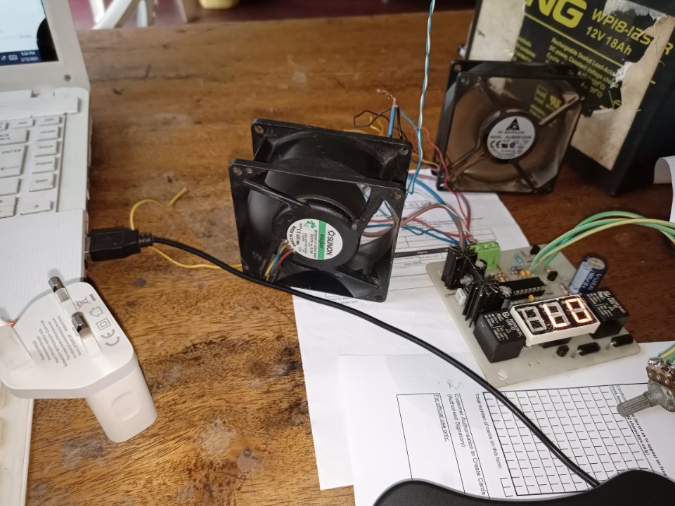

Re: 4-Wire Fan PWM
Post by Derrihj »
More

Re: 4-Wire Fan PWM
Post by Derrihj »
View toward night time.
