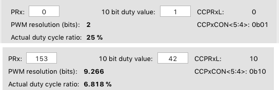

Yes, PWM has a number of discrete steps - each of a number of Hz...
For example 10 bit resolution will give 1024 steps over the PWM range.
The PIC documentation gives the following on 'PWM 'resolution
(sorry had to photo the page here - for better reading download from microchip.com)

Re: HOW PRECISE IS PWM
Hi martin
Thanks for the reply, ive experimented with 4, 8, 16 and 20 MHz clocks but didnt notice any difference in results even though by the data sheet saying 10 bit on the highest frequency (20 meg) as opposed the 8 MHz in your picture
Bob
For example, let's see the datasheet of PIC12F1840.
The PWM frequency is based on Timer2 settings (prescaler + PR2 values) and Fosc. The frequency is not is linearly related to the PR2 value. For equation, see datasheet. You can't say, one step in PR2 equals n Hertz. As you see, not every frequencies can be generated by a simple PWM generator and you can't create fixed step values. The precision of the PWM frequency is based on the precision of the oscillator.
Don't mix the frequency with the duty cycle ratio. PWM resolution = Duty cycle ratio resolution. You can get 10 bits if PR2=255. If PR2=63, the resolution is 8 bits. If PR2=0 you get 2 bits resolution and this means, you can generate 0, 25, 50, 75 and 100 % duty cycle ratio, no intermediate steps. For equation, check datasheet or use online PWM calculator.
