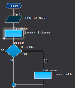

Hi, Frank.
To change the flowchart so switches are active low, all you need to do is change the switch properties from active high to active low.
That is so the simulation will work correctly.
Then within the timer interrupt, I added a calculation icon, just below the input icon:
Added Calculation.png (27.58 KiB) Viewed 9758 times
.Switch = 15 - .Switch

Hi Martin,
I had changed the properties of the switches from High to Low. That dint work, so I chanced so more things to see if it works. But it didn’t.
Your calculation did the job ! It works now perfectly :-)
Many thanks !
