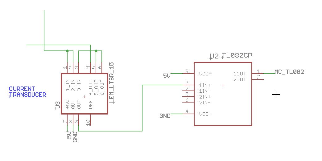

That depends on the current you want the LED to stay on at.
3V = 12A though the LTS/LTSR 15
2.8V = 7.5A

The component relies on the supply voltage to the microcontroller being as near to 5.00V as possible.
You must always set the VDD within the component properties to voltage going to the VDD of the microcontroller.
If the voltage set within properties is out, then the current reading will be out.
This is because the LTSR generates a precision voltage, e.g 2.50 when there is no current flowing.
If VDD to the microcontroller is 4.87V then the ADC will read 2.567V
Therefore instead of no current flowing, the current reading will be 1.44amps.
The voltage you need to enter for VDD will correct this.

If you inject a DC signal just remember that the sensitivity of the lts/ltsr 15np is 41.6mV/A
So you will either need a PSU with a course + fine adjustment or a 10 turn pot.
The voltage injected to the ADC for 0 to 7.5A = 2.50V to 2.81V so the full voltage range for 0 to 7.5A is only 312mV.
What is the precise voltage across your microcontroller supply pins?

If I get this to work then there is a another problem. The original PCB is from 2005 ? and there is a TL082CP between the output from the LTSR-15 and the PIC. Original there was a PIC16F876A ?? on board. The text on this PIC is almost gone
I have redrawn this damaged PCB as it was. So, also with all the components. It works great but the last thing is the LTSR-15 for safe use.
Attached there is a part of the schematic as it is. MC_TL082 is a connection to the PIC.
The LED is in the very upper right corner of this video.
https://youtu.be/qJzmZnVjQ-8
