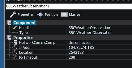

Has anyone any idea where the ip address in the BBC weather component came from, I've a feeling its changed.

Strange checking the ip address going through a mobile phone connection gave 104.91.71.134 which worked ok, any 3 last digits seemed ok.
But using my home internet BT the result came came as 23.59.171.41 which did not work why the different result?

The URL is resolved to an IP address using your DNS server, this might be something your ISP is providing and maybe there is a problem here. You could try forcing your computer to use the google DNS of 8.8.8.8 or the cloudflare DNS of 1.1.1.1.
