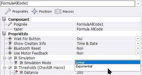

Re: IR sensor exponential response
Post by sundgau »
I am now using Flowcode V9 and I have just noticed that there is no possibility to choose the IR sensor simulation mode.
Screen Shot 12-14-21 at 11.17 AM.JPG (28.82 KiB) Viewed 23956 times
The simulation on flowcode V7 gave excellent results to within 1mm. The measurements in real life also gave a rangefinder with an accuracy of 1mm over a distance of 15cm...
Can you put this option back on Flowcode V9 so that I can resume this work with my students?
Thanks in advance.
Bruno
Hello Bruno,
Many thanks for letting us know. It must have been missed in the v8 and v9 updates. I've now added it back into the v9 component for you. You can get the latest version of the component by clicking Help -> Library Updates.
