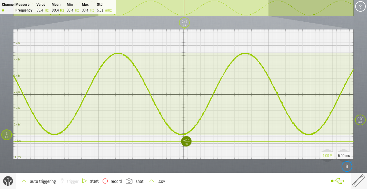

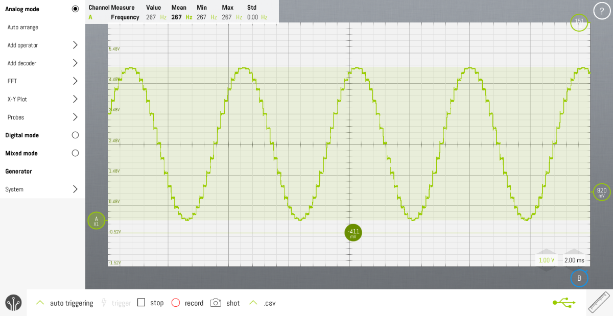

Not sure if this got sorted - or even if this will be useful...
However - the current project I'm working on needs a wave generator - not necessarily sine, however my code was easily modified to do this.
I'm using a discrete DAC (a MCP4725) - and (hopefully will be) feeding the output into an opamp to generate a -V .. +V wave.
So the code is very simple - you can use the MCP component in FC (v9 at least) - or do as I did and roll your own (partly because I want to save the DAC state to it's EEPROM - and because it's a good way of finding out how the bits play together..) Here using 256 values lookup data - though this is easy to change - 512 values gave a 16.7Hz wave.
And using a 32 value lookup table:
and the code:
dac sine wave.fcfx
(13.41 KiB) Downloaded 496 times
Note - this test on an Arduino with i2c running at 400kHz. A faster MCU could run i2c at 1MHz - so should be possible to generate 50 or 60Hz signal using this technique....
