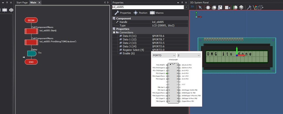

Hello, I'm developing a menu using an Arduino and a 16x2 LCD, but when I write the code on the Arduino, to show on the LCD, the values do not appear.
What should I do to solve the problem?
This is my flowchart and a image of the project.

Re: LCD 16x2 don't works with Arduino UNO in Flowcode 7
It could be the length of your wires causing the problem. Can you plug the LCD directly into the breadboard?
Does adjusting the contrast potentiometer help at all?
Looking at the picture you sent have you wired up the data bus as shown here. e.g. using the top nibble D4 - D7.
https://www.flowcode.co.uk/wiki/index.ph ... 954a4191ea

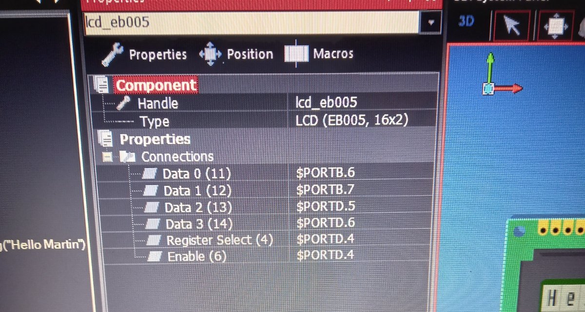

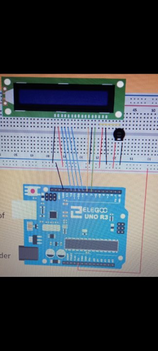

Longshot i know. See attached images. Using flowcode 7and trying to set pins for the wiring diagram atrached. Any help please. Students have exam soon.
Hi Martin.
To me it looks like the wiring does not match the pins set within LED properties.
Looking at your wiring diagram image, which is not very clear, you have the following:
RS > D7
EN > B0
D0 > B1
D1 > B2
D3 > B3
D4 > B4
Within LCD properties It looks like you have EN going to D4 etc.
Uno Digital 0 to 7 = PortD 0 to 7
Uno Digital 8 to 13 = PortB 0 to 5
Uno Analogue A0 to A5 = PortC 0 to 5
RS > D7
EN > B0
D0 > B1
D1 > B2
D3 > B3
D4 > B4

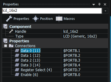

Thanks for the reply. Pin 7 or 8 are not available with the properties of the display so I have used 2 and 4 but still will not work.medelec35 wrote: ↑Thu Jan 13, 2022 12:15 pmHi Martin.
RS > D7
EN > B0
D0 > B1
D1 > B2
D3 > B3
D4 > B4
- Pin7_8.jpg (45.45 KiB) Viewed 17411 times
MartinSpeed
- Posts: 28
- Joined: Tue Nov 09, 2021 11:53 am
- Been thanked: 1 time
Forgot to say that it compiles but no message on the display.
?MartinSpeed wrote: ↑Thu Jan 13, 2022 3:37 pmPin 7 or 8 are not available with the properties of the display
pin7 is D7
and Pin8 is B0 as in the table I posted.
Looking at your wiring diagram you should have: As the diagram is not clear, can you state what pin of the Arduino (Digital 0 to 13)each connection of the LCD is connected to?
E.g.
LCD > Pin
RS > 7
EN > 8
D0 > 9
D1 > 10
D3 > 11
D4 > 12
