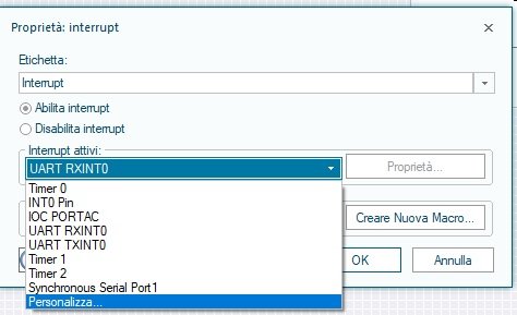

I point out that the micro in question has 4 timers 8bit and 4 timers 16bit, but in the interrupt property there are only three as shown in the attached photo. Why are the other timers not available?

If an interrupt is not available in the list, then you could use the "Custom" (or "Personalizza") entry and code this yourself.
